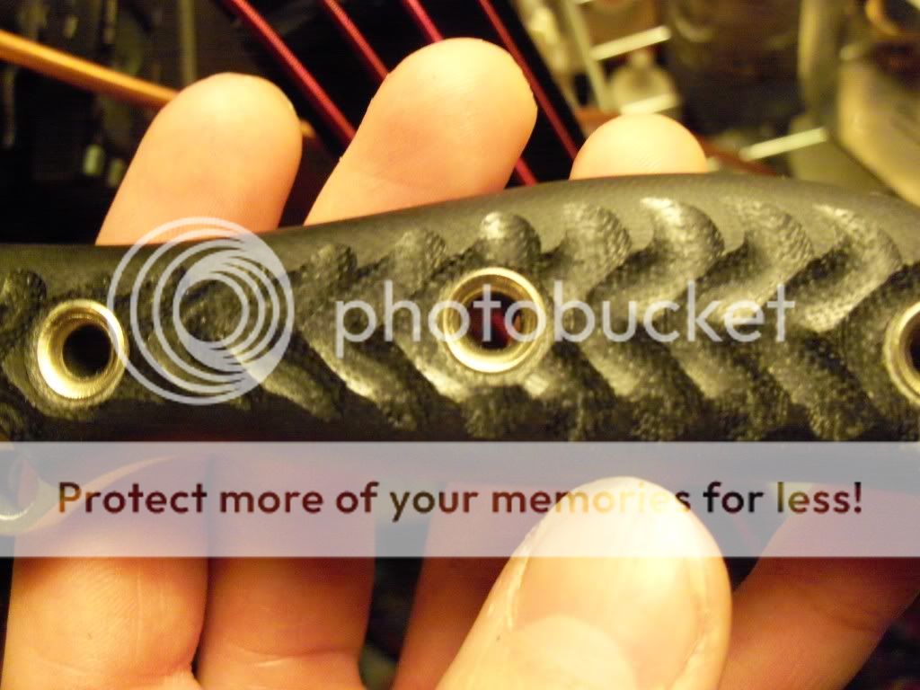

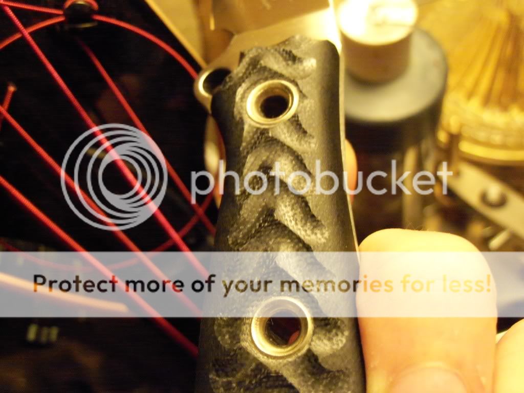

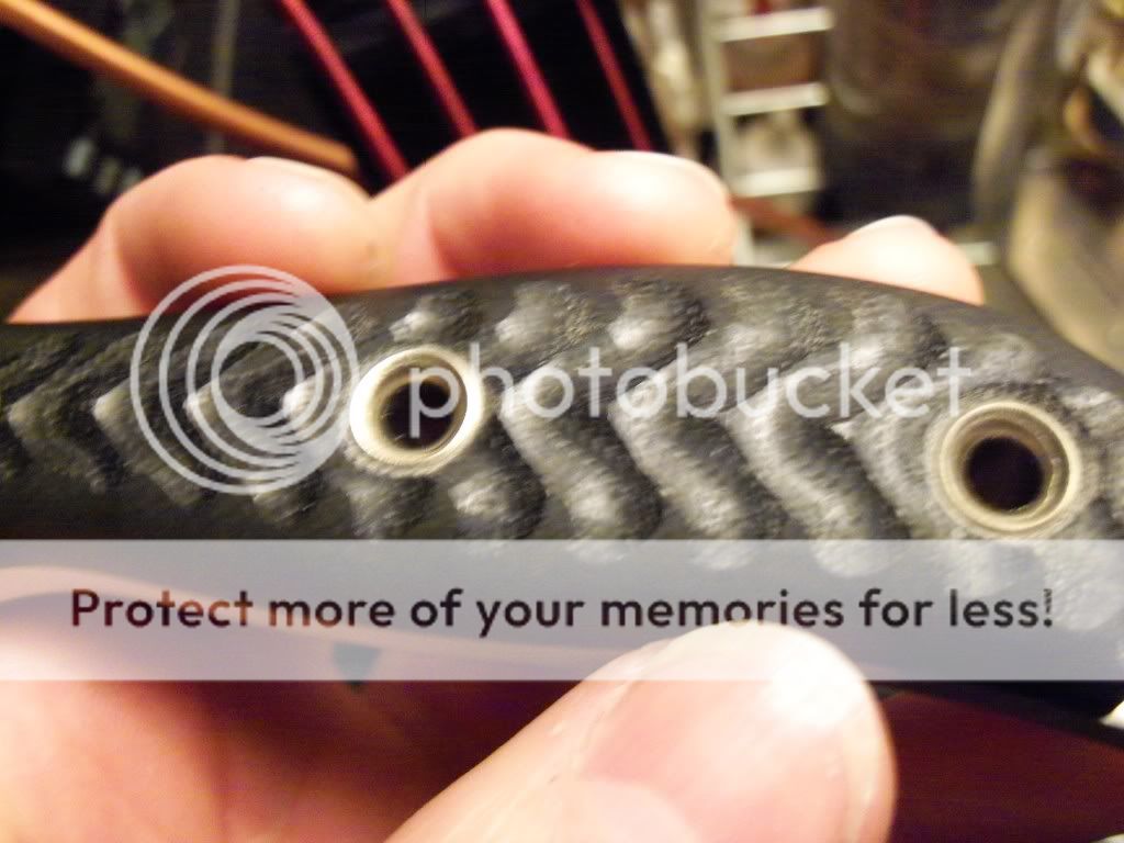

Hey there, I need help identifying these scales. I ordered a SLUT with black canvas micarta, and got an email confirming that I won the knife I wanted but this stuff feels like G10 to me. :confused:
I never felt canvas micarta in person so I wanna ask you guys. I wet it and it absorbed no water which leads me to believe its G10.
Thanks!
That looks like black PAPER, not canvas, then again, it looks like wet canvas
Still a sweet knife though
oh, micarta feels soft, smooth (mostly), but yet still grippy
Sweet score Reguardless!
But does not look like black paper to me, nor does it look like G10 quite?
Better lighting on the Pic would have helped.
It also looks much darker than my black canvas micarta did, unless I got it wet.
But it looks like I can see the fibers in the material, so I would say it is black canvas.
In my experience, black paper has very intricate light texture within it, black canvas (pictured) has a more fibrous pattern and black g-10 is pure black except for machine markings.
What he said, It looks like black canvas micarta to me as well. I think they are using better tools to make the handles now so the cuts just look cleaner.
This is the only pic I have with good lighting, but its not really a closeup..
I have a RAT rc3 with linen micarta and it feels more textured and grippy, more cloth like. This stuff feels really hard and smooth just like g10. Thanks for the help guys.
I believe that it's G-10. Has a similar look to my BATAC user which has the black G-10 handles.
ETA: I suggest that you send an email with these pix attached to Amy or Lexi this week...They can get a definite answer for you and if needed or wanted, Busse can take care of you from there. :thumbup:
Yeah, in better lighting it does look like g-10
anyway, be happy!!
G-10 cost more so you got a deal!!:D;)
