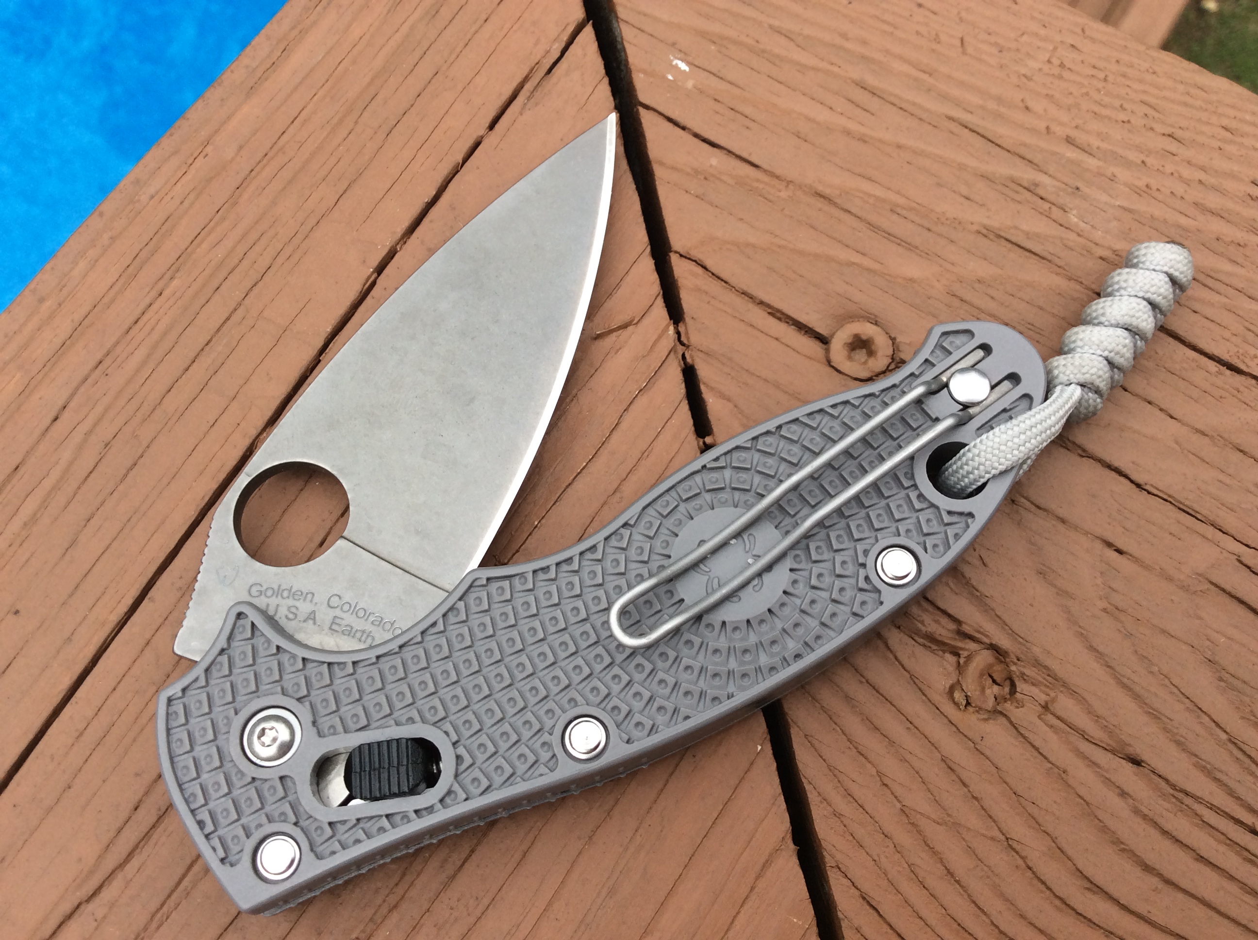

Sold a knife, and a bag, to get a Manix 2 after seeing that pic ^^^ I may blade swap it out for G10, we'll see.
Nice! I thought about doing this myself, but I can't bring myself to butcher up a perfectly good knife! How was it taking the maxamet manix apart? Did you drill the rivets out?
No drilling needed
It was surprisingly easy for my first attempt with the LW.
All I did was remove the pivot screw and apply a tiny bit of pressure to pop the blade on each side. It slid right out.
I actually think I could get the other blade into the FRN but haven't tried.
The internals had to be swapped as well as the screws are different sizes.
