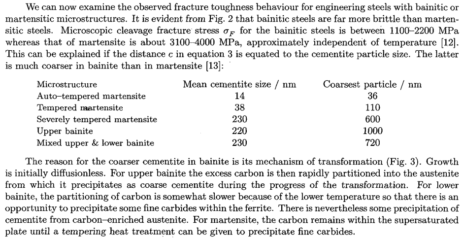

I also thought that bainite was the toughest microstructure for a given steel, but this source (http://hal.archives-ouvertes.fr/docs/00/25/56/55/PDF/ajp-jp4199707C558.pdf) says otherwise: “Because of the difference in the mechanism of transformation, bainitic steels have always been second- best when compared with tempered martensite. The lack of toughness can in principle be eliminated by using steels with a high silicon concentration (e.g. 1.5 wt%). Silicon has a negligible solubility in cementite and hence greatly retards its precipitation.”
I think in that source bainite was described to be brittle. Could someone shed some light on this? Reading other sources online bainite is supposedly tougher than other microstructures.​
Regardless, if it can be done, would bainite be a good contender? I understand that it would likely fair better in the Charpy test compared to just tempered martensite, but the lower hardness would be a pretty big factor.

FWIW, bainite is only tougher than tempered martensite at the higher hardness levels. Lower hardness (strenght) tempered martensite is tougher. I can't remember the cutoff, but it's in the 40s somewhere. Reference Verhoeven's book for bladesmiths for the cutoff hardness, as well as more information on austempering. The hardenability issues of 1095 pose challenges for austempering or marquenching and getting full hardness.
