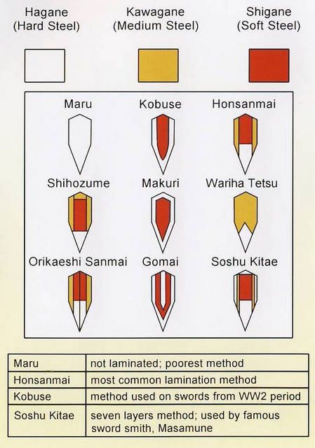

San-Mai would also be inaccurate -
it means three pieces (layers)
in Kanji - 三枚 -
the first character 三 (san) is literally the number 3.
From Wikipedia on Japanese Cutlery
San Mai generally refers to knives with the hard steel hagane forming the blade's edge and the iron/stainless forming a jacket on both sides. In stainless versions, this offers a practical and visible advantage of a superb cutting edge of modern Japanese knife steel with a corrosion resistant exterior. In professional Japanese kitchens, the edge is kept free of corrosion because knives are generally sharpened on a daily basis.
Honyaki and kasumi knives can be forged out of steel. Based on their kirenaga (duration of sharpness) and hardness, however they are more difficult to use and maintain. Additionally, there are high-grade quality kasumi knives called hongasumi and layered-steel kasumi called Damascus that have longer kirenaga.
Originally, all Japanese kitchen knives were made from the same carbon steel as katana. More expensive san mai knives have a similar quality, containing an inner core of hard and brittle carbon steel, with a thick layer of soft and more ductile steel sandwiched around the core so that the hard steel is exposed only at the cutting edge. Nowadays stainless steel is often used for Japanese kitchen knives, and san mai laminated blade construction is used in more expensive blades to add corrosion resistance while maintaining strength and durability.
Cladding blades (hard steel core with softer steel outer layers) has been a tradition in Japan for centuries -

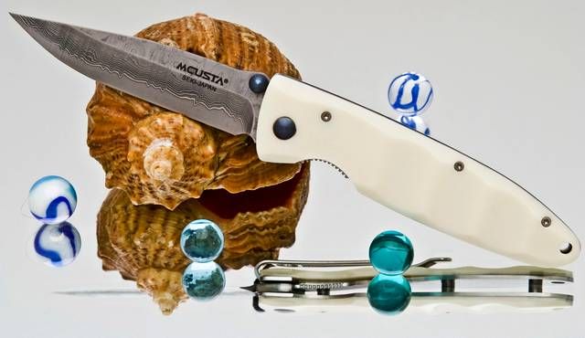

Mcusta MC-15D is the correct model number - the "D" is for damascus - and the Mcusta website on the Basic Series Folders MC-1 says:
MC-15D
Damascus Blade, DuPont Corian (R) Handle
again not my photo - but Vip-Horcea - re-sized and re-hosted
The basic MC-1 & 2 series are bigger knives with about 3.25" blades and 4.25" closed -
and being liner-locks which are very well made with Teflon pivot washers -
they are easy and smooth opening
I have the two MC-1 series models that sandwich your model #
and here's a photo of my two basic MC-1 series knives
(MC-14D cocobolo and MC-16D quince-wood)
sandwiching this Mcusta 113D "Tsuchi" -
I could not agree with you more about these being extraordinary value with top notch materials and construction -
like they claim -
MCUSTA stands for Machine Custom Knives!

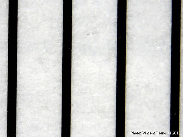

The version I got had measuring software supplied - and it can measure on screen -
the reason I say the magnification is about ~110x is because I used it on the calibration ruler supplied and calibrated it to the millimeter scale:
that's a mini-(3.25") CD
This is the 640x480 version of the millimeter scale for all my usb microscope photos -
The reason I say this usb microscope eliminates a lot of skill problems
is because I use it only with outer transparent bezel in contact with the object.
This makes things a lot more stable and the only difficulty is orientation and any move for framing has to be very slight.
The supplied stand is just too wobbly and difficult to adjust for distance.

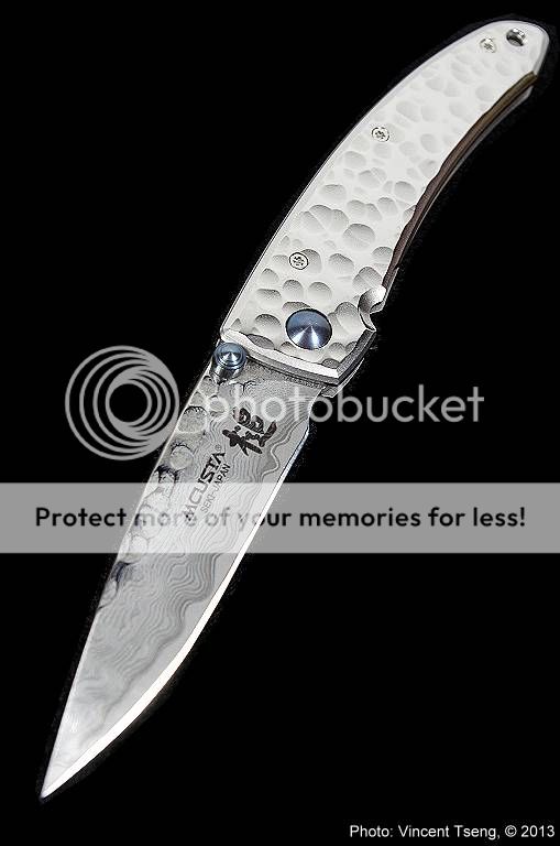

Very nice review, when I first looked at the knife handle, I thought of a view down into a stream bed and water flowing across rocks placed there, I would have NEVER guess it was hammered in texture ! I was just mesmerized by the look and your shots, very well done.
I noticed the tip down carry only, probably more a safety issue, but it always makes me wonder, why put a lanyard hole on a knife where you can't put the clip on that end :)
I suppose, if you were not to use the clip, then you could use the lanyard function, maybe...
Thanks for help,
G2
Hi doubleG -
Same here it took me a while to realize what that finish was -

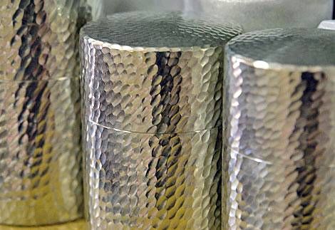

when they first came out I looked at the 111D "Nami" or Wave that made sense and kind of reflected the wavy damascus lines.
It wasn't until the popularity of the tsuchime or hammered finish Japanese kitchen knives that I realized what these "tsuchi" knives were about -
once I realized, then they kind of grew in attraction for me......
Of course, there are plenty of hammered finish stuff out there, from jewelry, flasks, canisters to other decorative finishes -

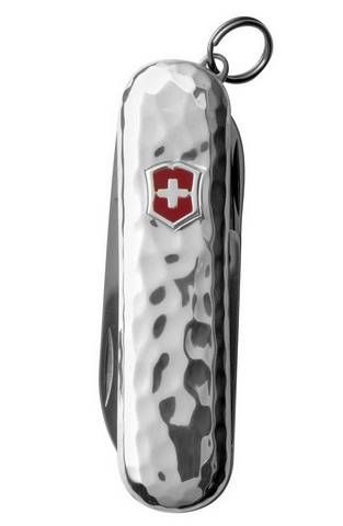

and a bit closer to topic - Victorinox had this sterling sliver Classic SD -
not my photos - off the web - re-sized and re-hosted.

Answering my own question - I went back and found the post that explained "damascus" using cladding with layered steel from Feb/2009! -
ref: Post#1770812
Loup Garou
Master Member KnifeNut!
02-21-09 17:54.27 - Post#1770812
There’s bascially 2 types of riki-zai or factory pre-laminated steels. There’s core steel which is bought clad already. I think that the two surfaces are prepared and then pressed together to create the bond; not actually welded. Many high class knives are in this style, such as Blazens or Sanetu.
Then there’s also layered cladding purchased without core steel. Many knives including some (but not most) traditional styles use this. As a raw material it is mostly unpatterend layers of steel, which is subsequently welded to a core steel by the maker who sells it. An example would by Hattori KDs. The cladding is originally a sheet of unpatterned and layered steel, but Hattori drills holes to a certain depth in the sheet, then heats it and forges it so the holes are filled and thus creating patterns. But I believe cladding can also be purchased already patterned.
The older Tanaka knives using Cowry-X are obviously hammered, but the cladding doesn’t look welded. So I think that the hammering was done on the pre-laminated blank. The actual surface of the blade above the bevel has no patterns, only indentations from a hammer. A wavy lamination line isn’t always an indication that the knife was forged, but in this case the cladding was forged (hit with a hammer).
All the new stock of Tanakas knives is welded, I wouldn’t know if the damascus is bought pre-patterned or not.
Shimatani’s damascus is welded, but the jigane is clearly riki-zai rather than being folded and patterned by the maker himself. There is no actual pattern. The steel is layered, but there is no surface pattern above the bevel. It’s basically just the layered unpatterned sheet of steel laminated to the edge steel. Most traditional knives using damascus cost upwards of $800, where the jigane is folded by the maker to create a pattern. The cost is a reflection of labour, because people will pay a premium for extra attention or manual work done. This has no impact on the performance of the edge steel though. But it’s important to realise that this $300 damascus isn’t the same as most $800 damascus. The value is great compared to JWW etc, but at the same time the premium doesn’t exist for a reason.
BTW - Suminagashi in Kanji: 墨流し - literally means floating-ink paper -
from Wikipedia on Santoku:
Some of the knives employ San Mai laminated steels, including the pattern known as suminagashi (墨流し literally, "flowing-ink paper"). The term refers to the similarity of the pattern formed by the blade's damascened and multi-layer steel alloys to the traditional Japanese art of suminagashi marbled paper. Forged laminated stainless steel cladding is employed on better Japanese Santoku knives to improve strength and rust resistance while maintaining a hard edge. Knives possessing these laminated blades are generally more expensive and of higher quality.
