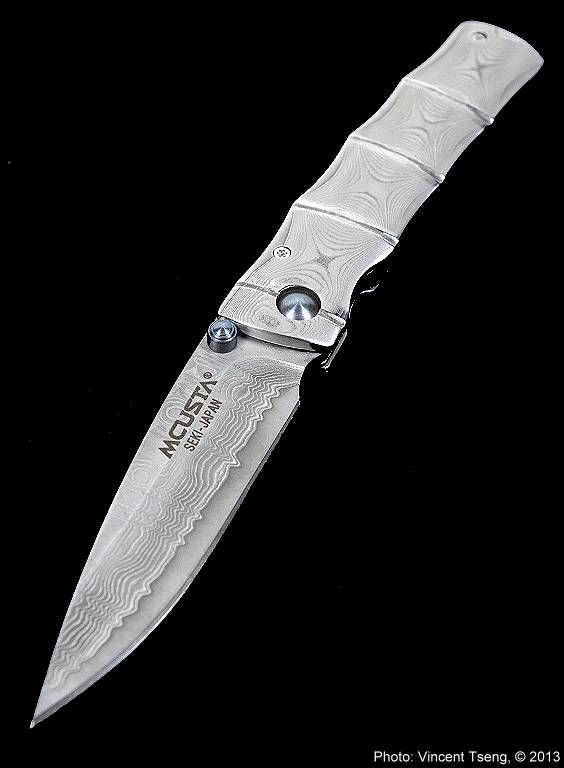

The MC-33D "Take" is in the Mcusta classic damascus folder series MC-3 -
from their webpage
The Classic Damascus Folder Series is inspired by traditional Japanese design elements. The blades are made from a VG-10 core forged with 33 layered nickel Damascus. The handles are all solid Damascus with an anodized pivot pin and Teflon washer system and each has an ambidextrous, one hand opening mechanism with liner lock. Each knife comes with a decorative woven Nishijin pouch.
3 1/2" closed.
Described by Mcusta - " handles are all solid Damascus " -
this is kind of right -
but really they ought to be called
Mokume-gane Japanese/Kanji - 木目金
mokume 木目 is wood eye or burl/grain
(BTW "me" 目 is the same character used in Tsuchi-me - hammer/mallet eye - see: Review - Mcusta 113D - "Tsuchi")
and gane 金 in Kanji (and Chinese) is gold - but in this case it is used for metal.
(so roughly wood grained metal)
They are as all small damascus Mcustas 3.5" closed (CORRECTION thanks to arty in post #3 my measured length is actually 3 5/8" along the middle of the handle) with 2.75" blades -
Qualification for the term damascus - I use it since Mcusta and everyone else is using it -
but these are really vg10 core steel clad with "damascus" patterned layered nickel and steel.

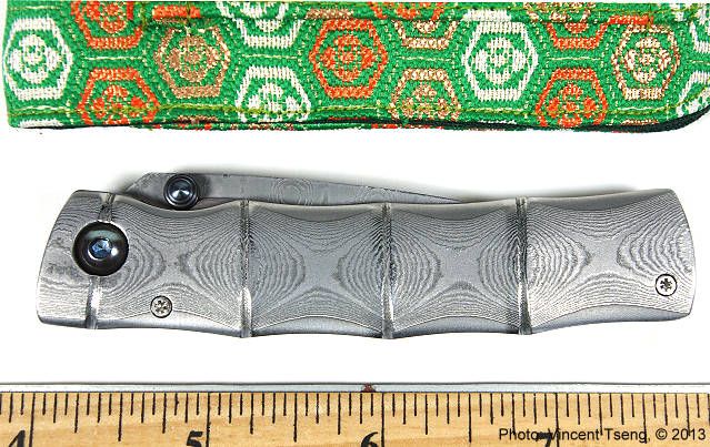

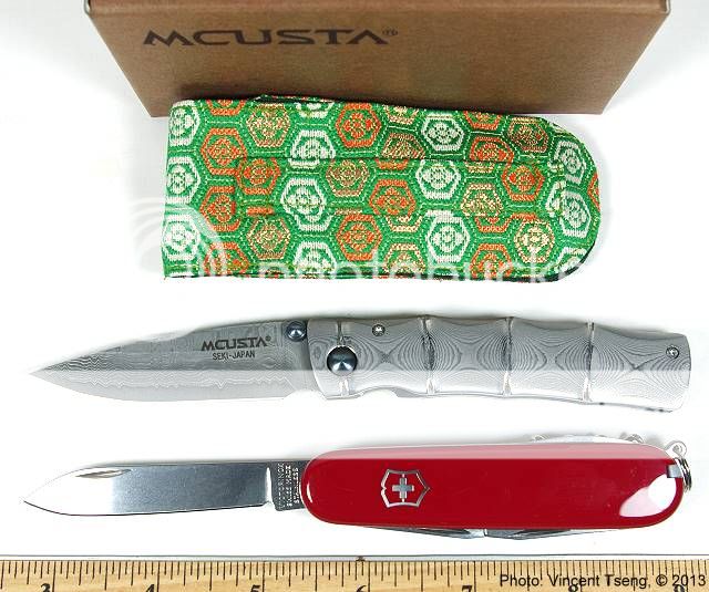

Size:

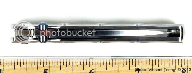

Closed -

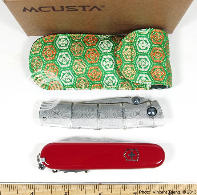

compared with standard SAK (Swiss Army Knife) - Victorinox Spartan -
shown is the decorative woven Nishijin pouch.

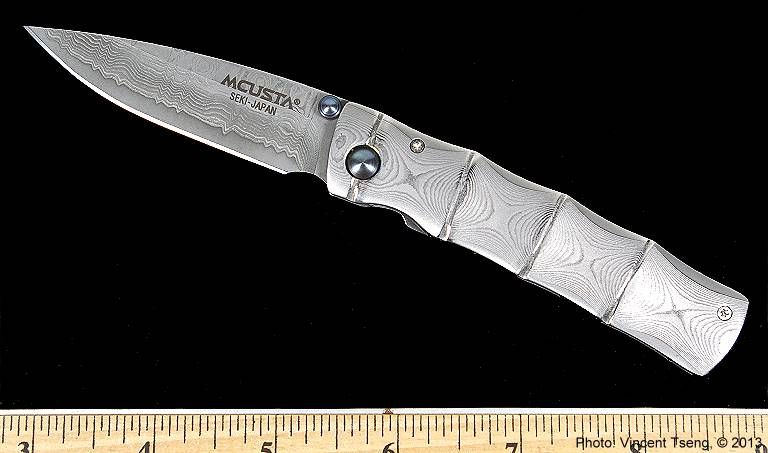

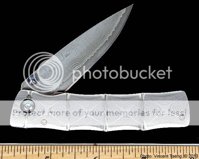

Open -

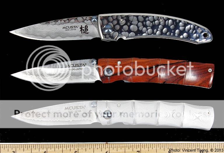

Being all steel the 33D "Take" has a pretty solid feel/weight
33D all steel "Take" = 3.29oz
74D cocobolo "Take" = 2.13oz
113D "Tsuchi" = 2.60oz
SAK - Victorinox Spartan = 2.08oz

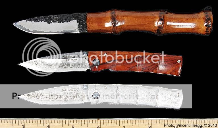

As mentioned elsewhere sometimes makers call their knives by the same name -
"Take" is also used in the Mcusta MC-7 series Classic Wood/Damascus Folders
compared to the Mcusta 74D cocobolo (also called "Take") and the Mcusta 113D - "Tsuchi" (link to review)
"Take" in Japanese/Kanji is 竹 - same as the Chinese character for bamboo -
shown with the 74D cocobolo "Take" and a knife with real bamboo handle.

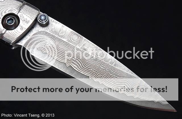

All the Mcusta 2.75" Damascus blades are the "same" - excepting the slight variations/uniqueness of the damascus pattern - even that is similar.

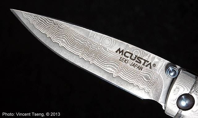

33D blade
That is except for the 113D "Tsuchi" (and the 111D Nami) -
I prefer the pattern of the 113D "Tsuchi" - as the lines are more flowing/organic.

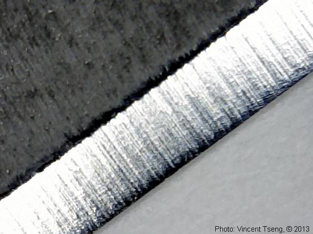

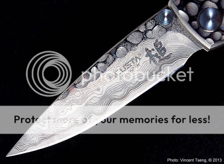

The blade is very, very sharp out of the box -

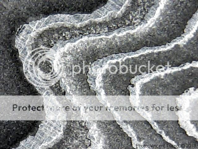

usb microscope pics (about ~ 110x magnification)-
Edge -

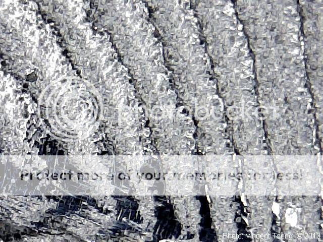

Damascus pattern on blade -

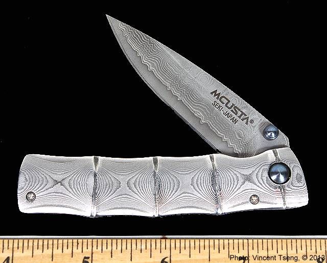

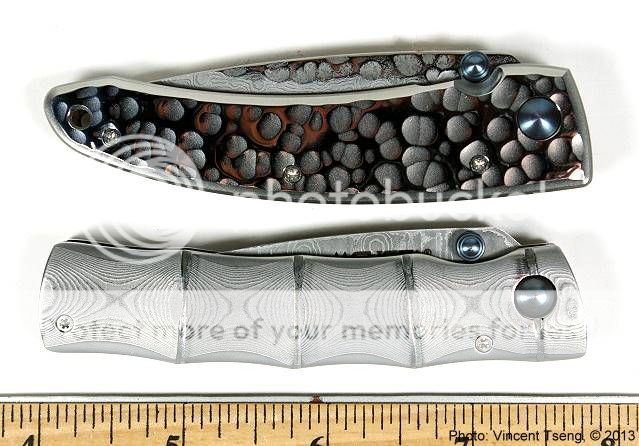

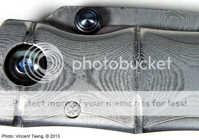

Damascus pattern or Mokume on handle -

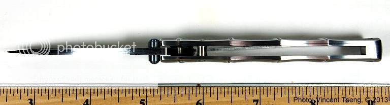

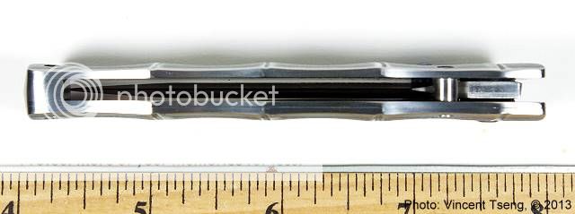

The liner lock-up is almost perfect -
Blade is well centered in the handle -
Everything is nicely aligned -

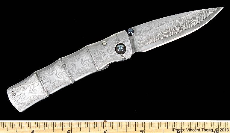

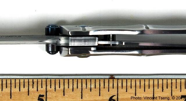

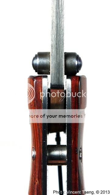

Mcustas use the thumb-stud as the stop-pin/bar -
but on my sample only the right-hand std makes contact with the handle/liner -
at first I thought this might be a fault - but it does not affect the function or integrity of the knife - there is no play in the blade locked open whatsoever.
My Mcusta 74D cocobolo Take is also the same way with only the right stud in contact with the handle/liner -

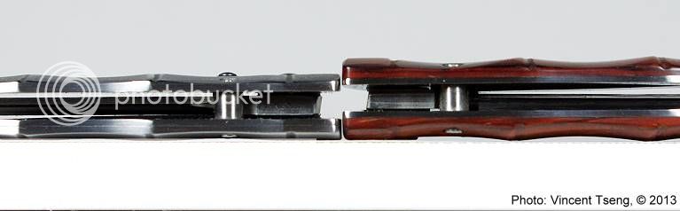

From your photos, it looks like the steel clad Take handle is a little thinner than the one in Cocobolo. Is this correct?
Thanks arty - well observed -
Yes, the 33D all steel "Take" is thinner than the 74D cocobolo "Take" -
The actual measurements at the thickest part at the pivot end were:
33D all steel = 0.4165"
74D cocobolo = 0.528"

Thanks wolf5391 -
Those aren't proprietary screws, pretty common, and almost a standard for knives -
The pivot is a 3/32" hex or Allen screw.
That 6 pointed star shaped scale screw looks like a T-6 Torx (link to Wikipedia entry) -
they were "strange" in the early 2000's but became almost a standard for knives -
many knife manufacturers sold their own Torx sets -
but they were relatively easily available - at economical prices.
I had an old thread back in June/2004 about such a set -
it even had an "identi-kit" photo for the physical location of the Torx driver in a store (see Post #25).
Use part # 74502 in a search at HomeDepot.com
Surprisingly over 9 years later the price is still the same.
CORRECTION - On further research that 6-pointed star screw may be a linehead or gamebit screw (used on Nintendos) -
but I find my Torx drivers do seem to fit.

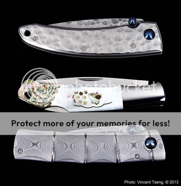

I personally like the looks of the 33D Take over almost any other Mcusta except for the 113D - "Tsuchi" (link to review)
Probably 3 of the best looking and elegant knives I have -

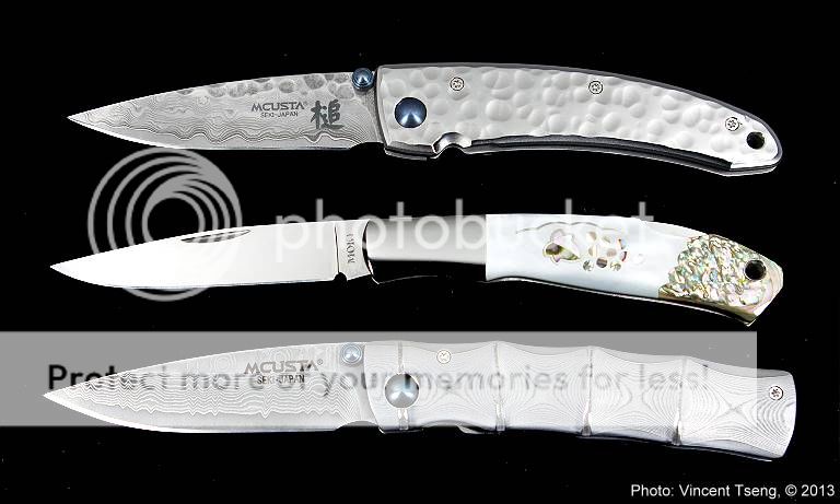

top to bottom: Mcusta 113D - "Tsuchi", Moki MK-509 "Aiora" (mother of pearl and abalone), and this Mcusta 33D "Take"
