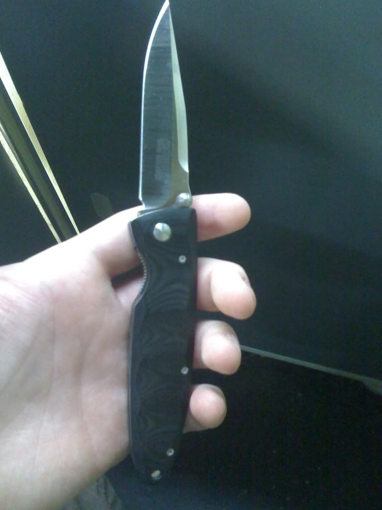

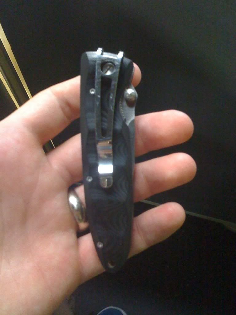

Here you go:

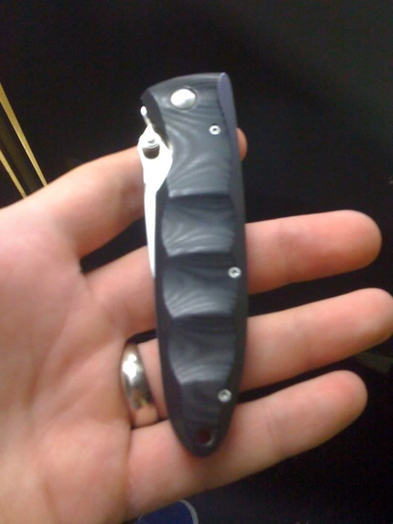

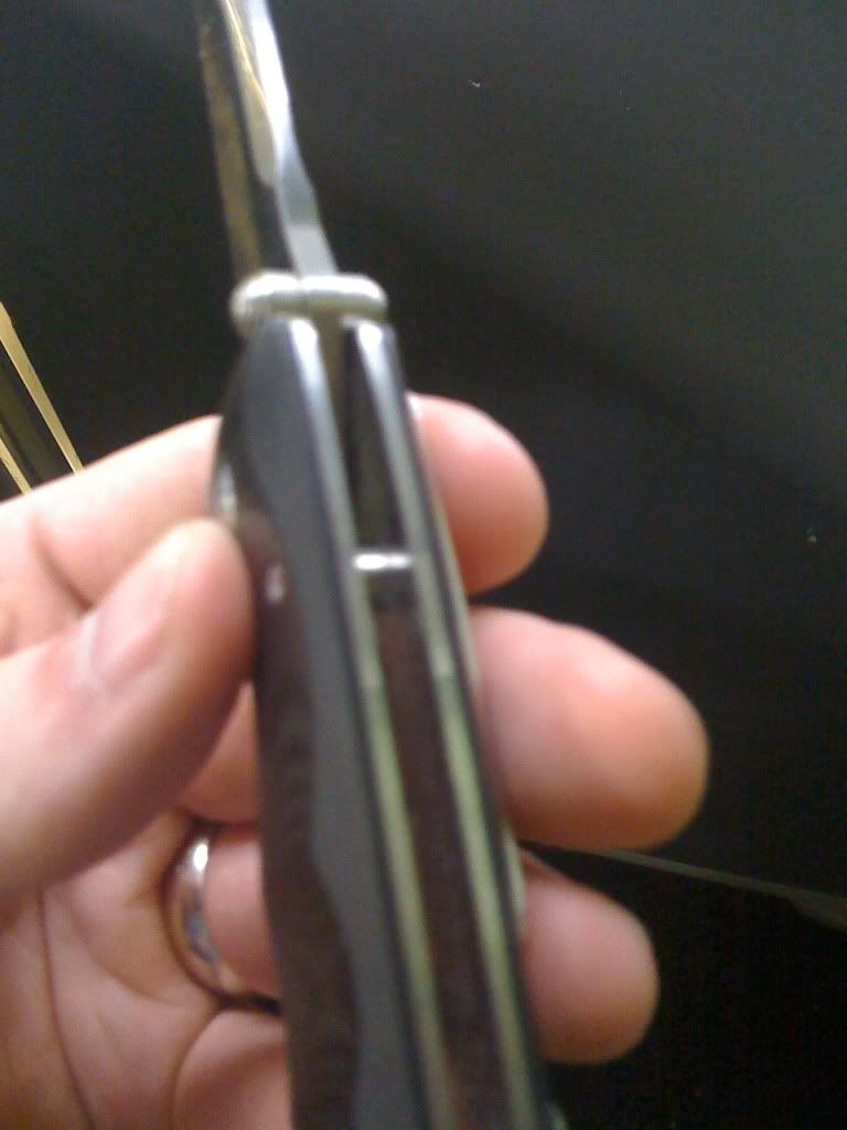

here's where I was wanting the jimping, maybe an inch of it just below the blade.
Sorry for the terrible iphone pics.
Also, I was wanting to grind down the liner lock so that it sits flush with the scale.

No they help some and bring up some things I see immediately. The problem I see with the stud replacement is that it is apparently also doubling as the stop pin for the blade on that knife. I doubt anything I have is going to replace that and I'm not even sure its something I could find. I wouldn't hold my breath on that part. Not from me anyway. My thoughts after seeing that are that it is so contingent on the proper lock adjustment that if it were mine I'd leave it alone. The easiest way to prevent the thumb studs catching would be to send that off to Curt to have some scales made and do that first and have him make the scales just a bit thicker than stock so they cover the stud making it recessed back in further on the body. In other words the knife would be slightly fatter but it would be less likely that the stud would overhang off the sides to catch on things that way.
Second reason Curt should see it first would be this. On the clip. If the clip is held in place by the pivot screw and the proper tension of the pivot adjustment for the blade is contingent on the clip being in place then you are also looking at the cost of replacing that missing clip with an equal thickness piece of titanium or breaking or cutting off the clip itself to stick just the part the pivot needs back in there. Hope that makes sense. In other words if the blade pivot won't properly tighten down because the screw bottoms out once you remove the clip it could lead to another separate issue. If the clip is removable and you can still use the knife clipless it should not be a problem. I can't tell looking at it. Curt could just do away with all of that by replacing the scale and making it thicker to begin with so there was no longer a need to have that clip mounted and kill two birds with one stone so to speak.
Only other thing I see as a possible temporary road block with the existing scales and possibly a third reason to get it Curt first would be the grooving on the handles and trying to find a flat spot to mount a clip in tip up carry mode. May have to make a flat spot to make it sit flat in that case but I won't really know without seeing the knife on that. It could mean taking the scale off and milling out a small flat area that the clip can rest which would not be needed if the clip could be mounted on a scale that was already set up or made from the get go with the expectation that a clip was going to mount tip up carry right hand. Hope you follow all that.
