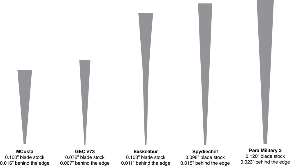

  Edge thickness:              0.4 mm (0.016”)

Thick edge.

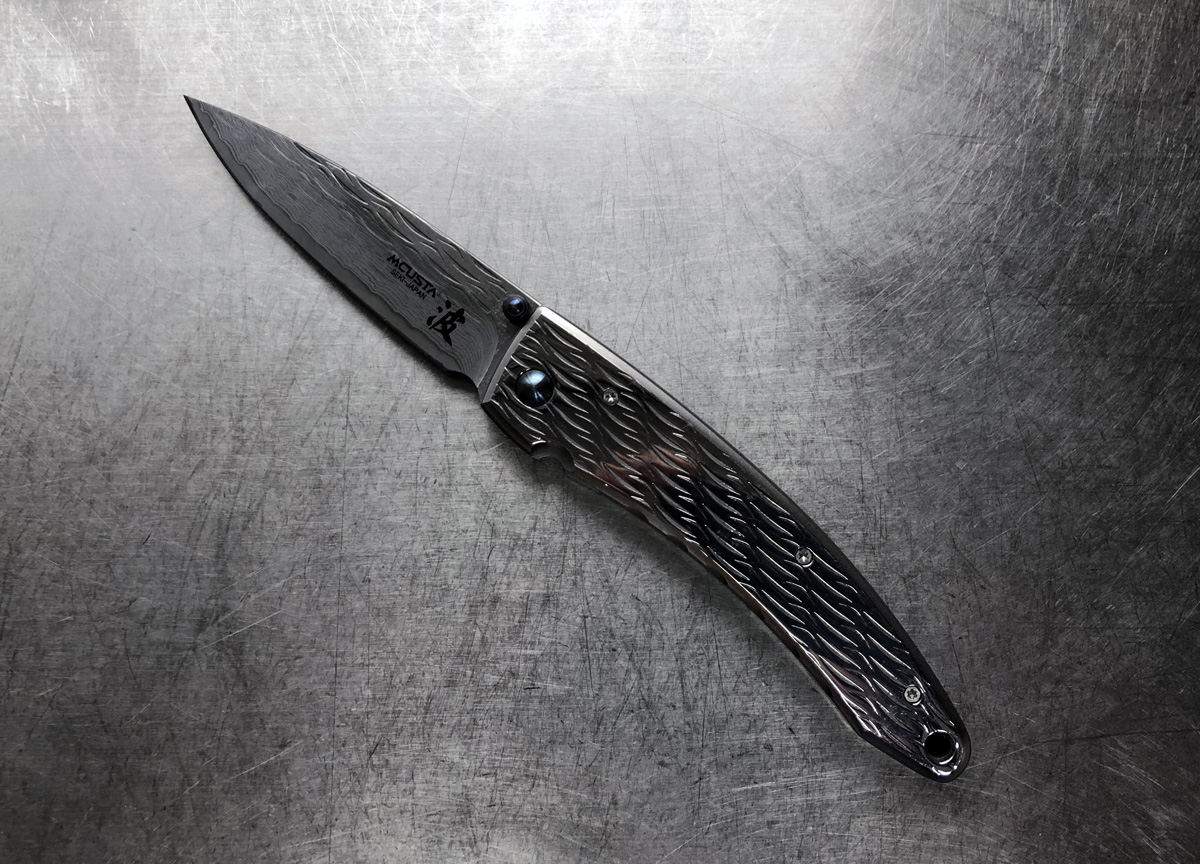

It is a pretty knife.

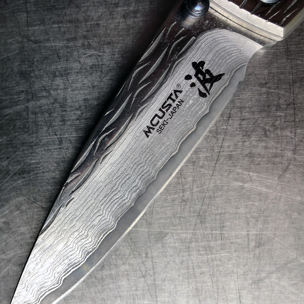

Particularly, the blade looks great.
However, the knife would benefit from taller and deeper flat grind for better performance.

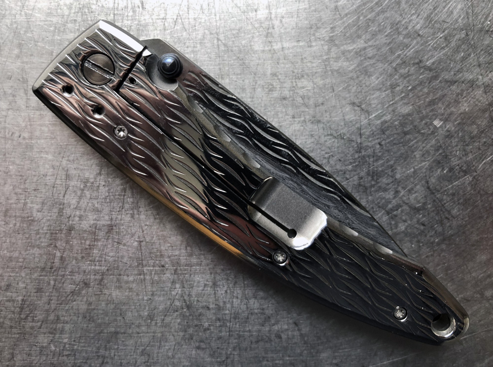

The steel handle slabs are textured with a wavy pattern.
It doesn't help much to make the handle grippy when wet.

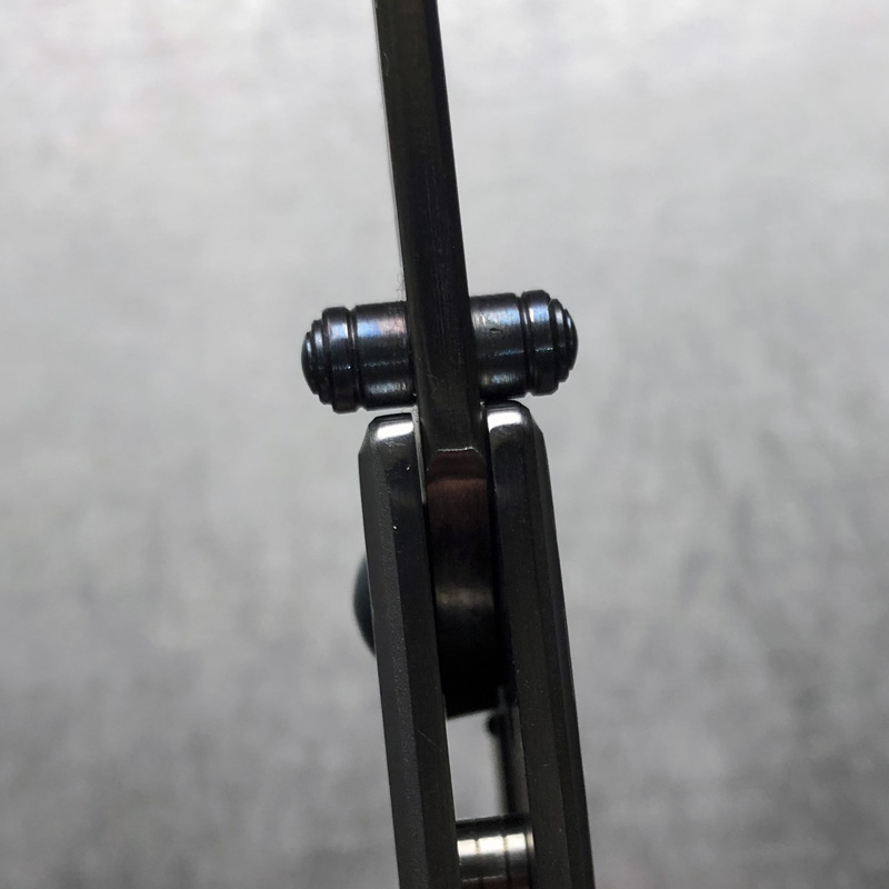

Particularly, the thumb studs, which function as the stop pins, should be better placed.
(There is another stop pin inside for the closed position)
On mine, only one of them contacts with the scale.
Very disappointing.
