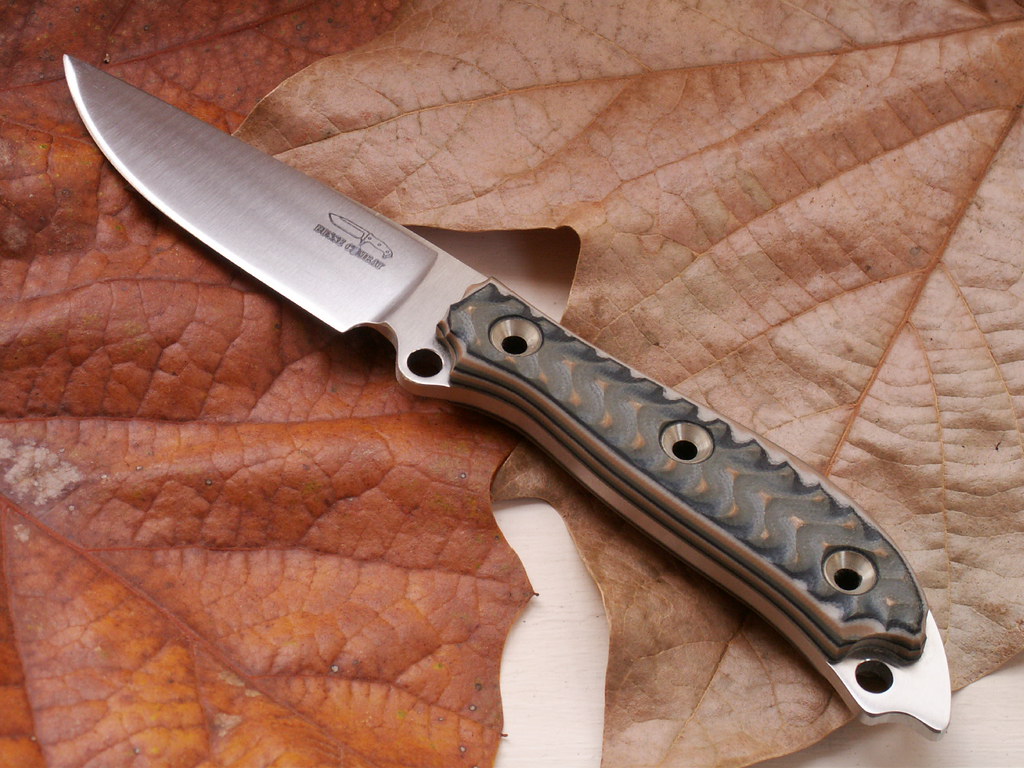

I've really reduced my fixed blade collection a great deal and getting an itch for something...well..mean! Can you guys school me on these two? Even the specs aren't clear to me. Pics are always welcomed of course! :D Wondering if the Leaner Meaner is still up for mistreatment or if I can lose the tip?
I grabbed this Leaner Meaner Street beauty from KnifeHunter:
Specs:
Busse Combat
Model: Leaner Meaner Street
Edition: 2013 Blade show
Blade Steel: "INFI"
Blade Length: 4.00"
OAL overall length: 8.75"
blade thickness: .1545"
Grind: Flat
Edge: Convex
Handle material: Jungle Storm G-10
Weight: 6.1oz
I love this little knife and I'm always looking for an excuse to use her. She fits my hand very well and slices like mad. :D
Done a lot of kitchen duty with her! :thumbup:

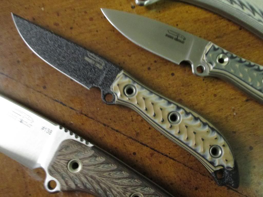

Here's mine - - - Leaner Meaner Street (I think)

Just like the specs say New and Unused from Blade 2013. This is a very limited run of one of the finest EDC's to come out of the Busse shop. These are razors and all have convex edges.
As Guy and Dwayne mentioned the original Meaner was .22" flat and the original leaner was sabre ground at .15" with both having v-edges. The new run was .15" flat with a zero convex edge making these IMO the best slicers in this version ever made. Here's some originals to check out:)
Top two are original as you can see by the smaller talon holes. Third one down was a later run Leaner. Most below that are the even later made .22" sabre ground meaners that came out in the years following the first PA show with the canvas /pins
compared to the 2013 flat ground .15 leaner with convex edge
With so many versions of Meaner/leaner its easier to remember the meaners being .22" and leaners being .15" both having flat or sabre grinds along with the date of release.
Hey Brother,
Awesome! I wondered where that Jungle Storm G-10 AD went! :thumbup:
Yep, it looks like yours is a Leaner with Sandstorm G-10.
