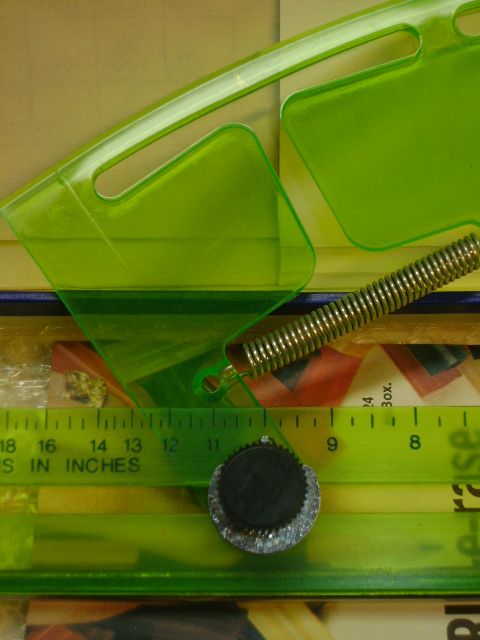

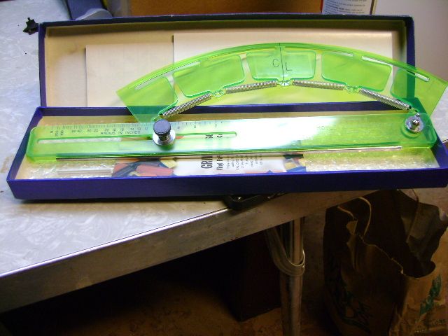

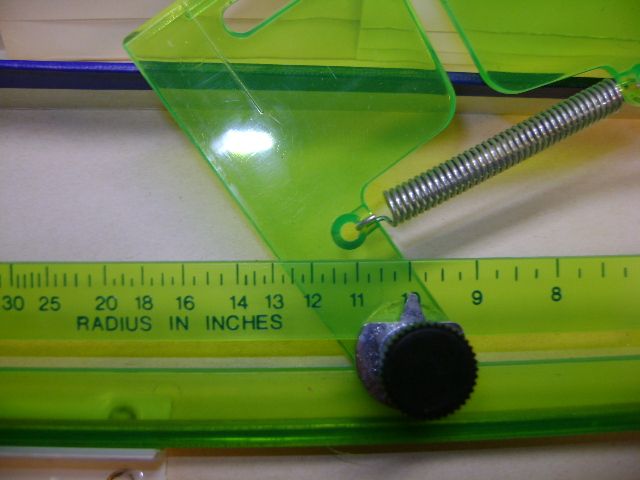

I found a solution to my hollow grind measuring dilemma in my old drafting equipment. A gadget called an Acu-Arc Ruler.
It will let you set it to arcs from 7" on up................. Works for me

Glad you enjoyed that. It will do the job on hollows over 7". Under that I think I'm going to have to take a compass and some thin material i.e. cardboard, micarta, aluminum, plastic, whatever and make a set of measuring tools to assuage my curiosity.
