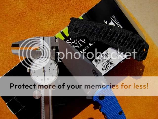

measuring blade thickness with a caliper.
I use a dial micrometer which reads in thousandths of an inch. You can get one for thirty bucks or so. Easy to read; very accurate.
Yeap I use a dial micro meter. Been lots of generations of machinists using them for years measuring machined parts. I guess it's good enough for me. Your mileage may vary!

The only thing I have to add to this is that the tips of callipers are notoriously inaccurate and cheep calapers are even more so. There are a few things that affect this but one thing is leverage. Also the tips wear and if the tip is not a crisp sharp edge and your using the tip to mesure then your already set up for problems. A general rule as a machinist, i trust our calapers to a tolerance of .005. If it needs to be tighter then that then we use a mic. I only use a mic to mesure edge thickness. Most mics at least good ones are carbide faced and have good sharp edges. How I do it is start closed and slowly open it up while I'm testing. What I'm looking for is the blade to catch in both directions. When it just catches and can't move left to right it's in between the anvils of the mic. This will give you a rather accurate measurement. Also I find using a mic a lot easer then callipers. Easy way is to run you pinky and ring finder through the D section of the mic with the thimble up between your thumb and pointer finger. Slide the edge back and forth across the gap between the anvils and slowly open it with your thump and pointer finger. As soon as it catches your there.
