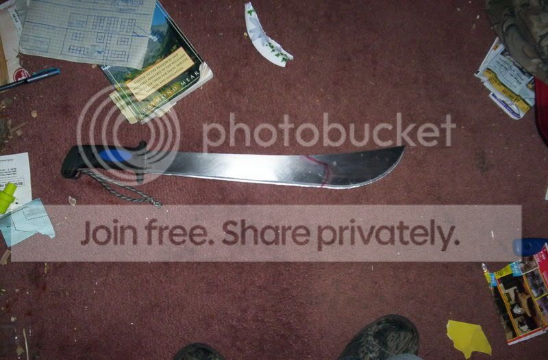

i would like to know what the steel in a harborfrieght machete is.its the 5 dollar one with the sof handles because if it is high carbon like it says it is and i suspect it might be because it holds the edge i gave it very well
if it is i would like to cut it down into a golok type thing

would it work for cutting into a golok type thing? i can post pics if it would be better

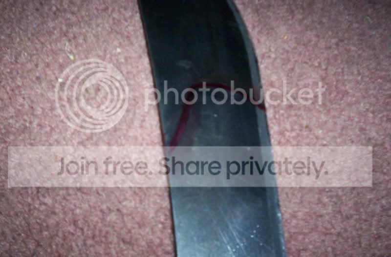

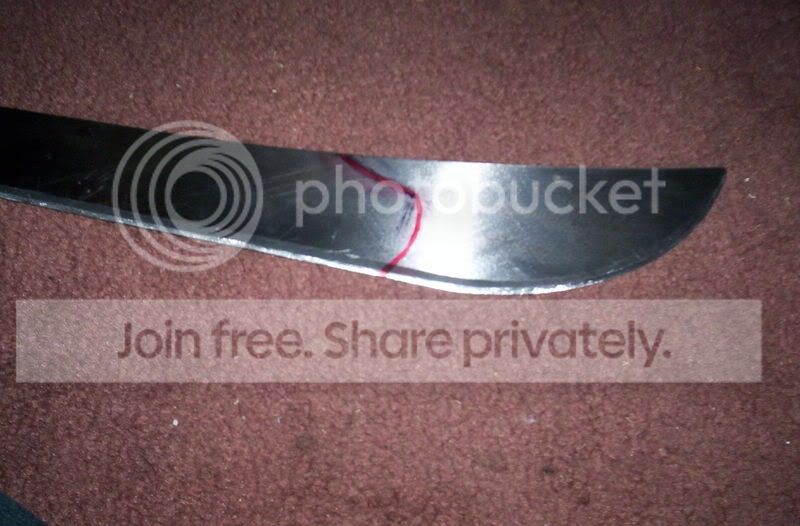

sweet! any one wanna see pics what im gonna do? and if i use a 4.5 inch angle grinder will i have to soak the blade in col water as not to screw up the temper?
We love to see pics of modified knives!
Yes, dunk it in water OFTEN. Your temp guage is right on the end of your hand, it's called a fingertip. If the metal is too hot to touch, you're taking big chances with the temper. If it turns blue, you have ruined the temper. Go slow and dunk often, it will be fine. Also remember that steel is easy to grind off, rather difficult to put back on!
