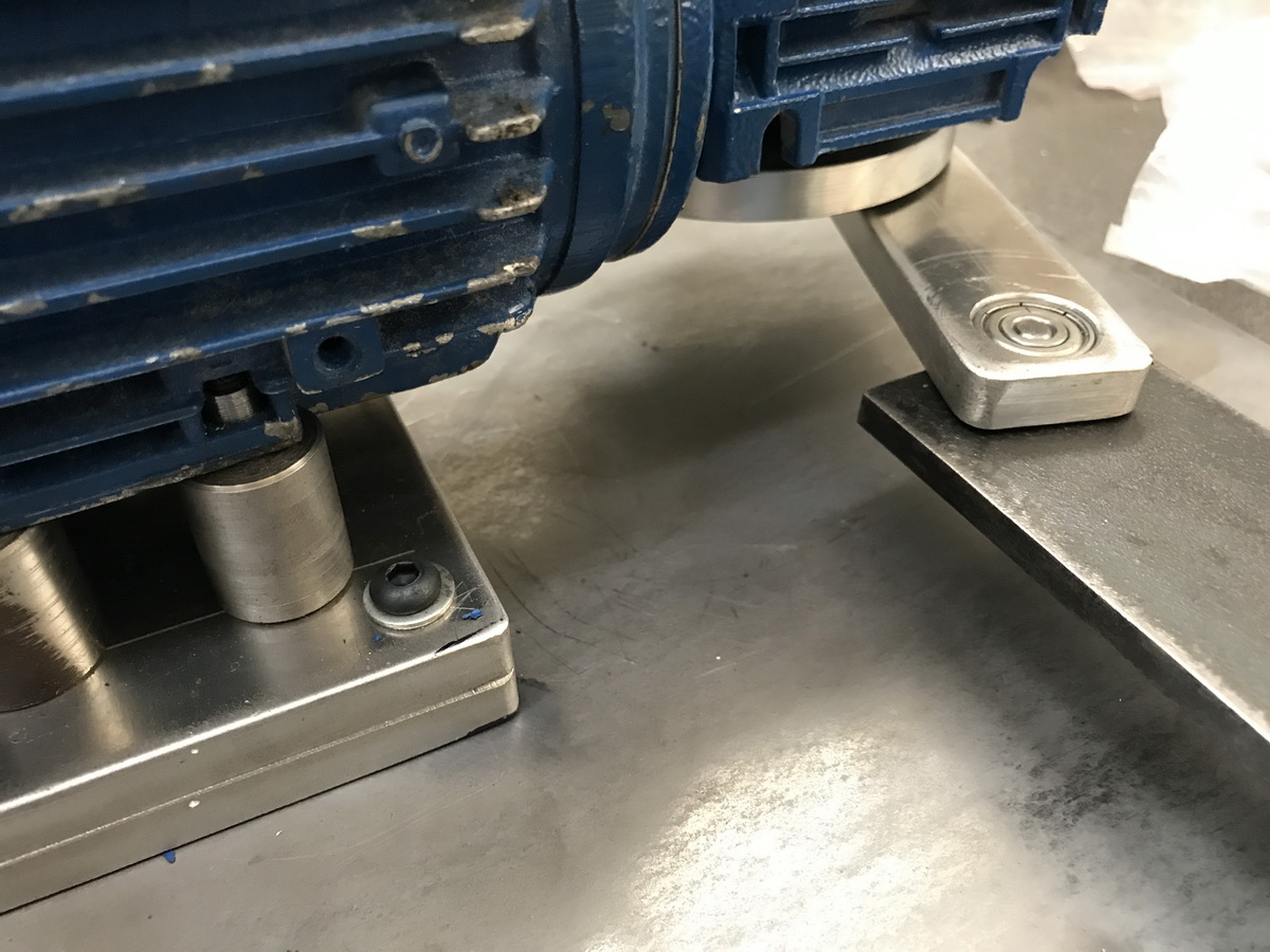

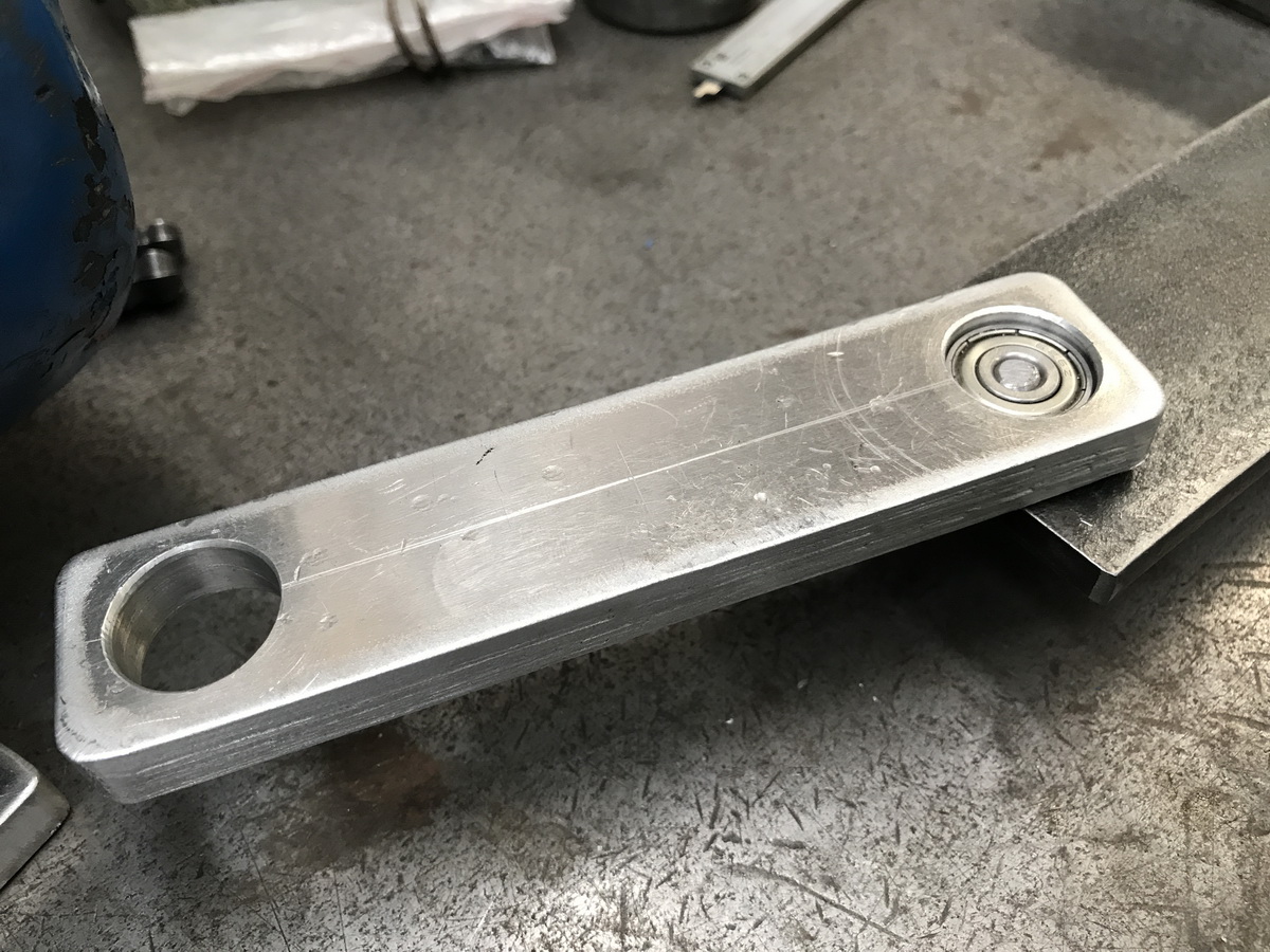

A few weeks ago I saw a russian video for a mechanical sanding machine (posted it in the videos thread) I keep thinking about it so I went to a scrap parts warehouse and checked if I could find a small and cheap reducer+motor, found it, so with its 3D model and solidworks I modelled my version of the machine:
I had all the remaining parts from previous projects so, taking time from other activities, I began the build, it took all the mornings of this week, and today I finished the main setup, it still needs a proper VFD support, mains switch and the palm rests on the side of the reciprocating arm, but being friday I wasn't able to wait until finished and I tested with a small knife I had almost finished.
It works, and it works very nice, the knife is hardened and had 240grit belt marks, so I cut a strip of 240 sandpaper and turned it on. Five minutes later and only half of the sandpaper strip I can go to the next grit, the effort is minimal. I'm happy.

Here are some photos:
