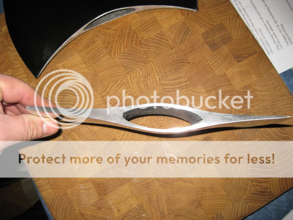

Medium double edge axe
Aug 16, 2005
136
Hey !!
This week I forge and grind some double edge axe it´s weigth 1 kg and are 230 mm long and the edge are 130 mm it will have two different edge hope you like it.
Cegga
I'd love to get my hands on one of those!.... Look at those thin Cheeks!!! It's a light-saber!
THAT is very pretty, great lines, thin, you could throw that. ;-) What steel did you use, what heat treat?
Great work.
regards
Robin
Thanks all :thumbup:
The steel are the same as it is in a Gränsfors and all the rest of the sweden makers .when I buy the steel the name are HB 3 and I will heat treat it to something around 55-60 HRC
What you want to know more :confused:
