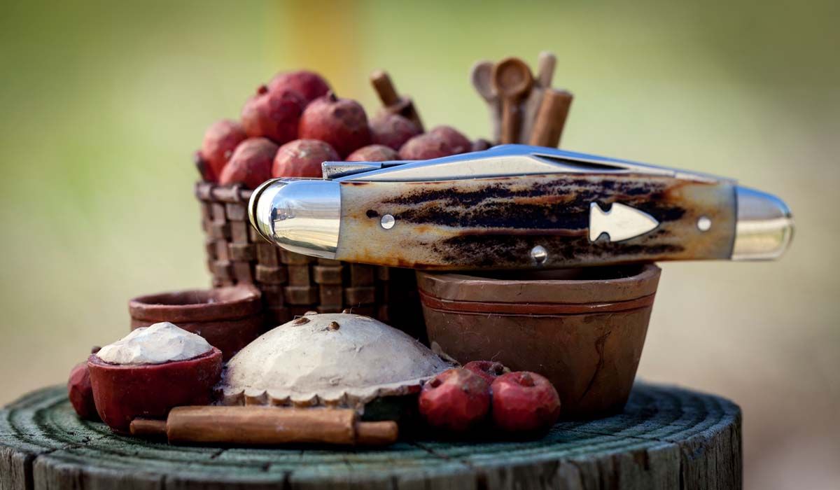

Hi folks, while I did have a very nice Ivy Green Case medium Stockman it lost out to the Ivy Green Peanut I had, too many Ivy's for to few pockets, so the medium stockman flew away. Later on the Peanut also left the coop, lovely knives both. I had a larger regular Case Stockman but found for everyday it was just a tad too large, you can see the goldilocks in me coming out can't you ? :) so I still wanted a watch pocket knife and saw a Northwoods stag medium stockman up for sale and picked that up. It just arrived and while a nice looking knife the blades certainly needed some attention in the sharpening dept, which showed up some grinding flaws overall, but, long story short, they did sharpen up and with the D2 steel, which proved to be pretty hard, they took a very nice edge.
Typical G2 style when it comes to stockman knives, I am not partial to a spey blade shape, nor do I like the big hump that the sheepsfoot blade makes of the skyline of the knife when all blades are closed. So, my first job was to turn that spey into a 'Pen blade', doing that allowed clearance to be able to lower the sheepsfoot down into the frame so that it's spine was even with the clip point blade. The nail nick clearance was achieved from grinding down that spey blade into a 'pen blade', otherwise the nick would be blocked. It all worked out fine, the overall look of the knife while closed is a very sleek trim folder, plus it rides in the watchpocket better too. And when using the clip point or the 'pen' blade, you don't have that hump from the sheepsfoot digging into your palm. Now grinding down the kick on the sheepsfoot you will see that the back spring will sink down just a smidgen, but the overall usefulness of the setup, to me, is worth it.
Here are some images of my new Northwoods Stag Medium Stockman folder in D2 steel, made in Gladstone MI.

pile side had great stag on there too, and you can see how the nail nicks have JUST enough clearance for either blade now. And the sheepsfoot blades spine is even with the clip point's spine.

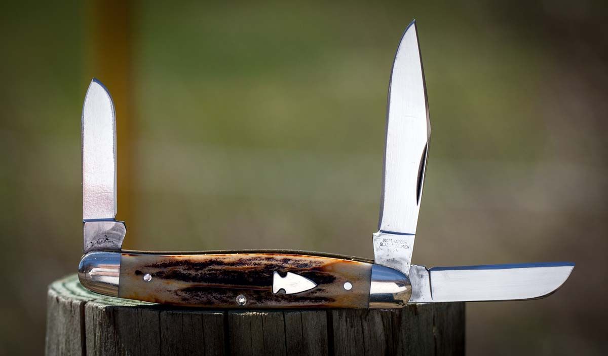

Northwoods_medium_stockman.jpg~original
All three blades, while the modified spey blade isn't a true pen blade, it's close...

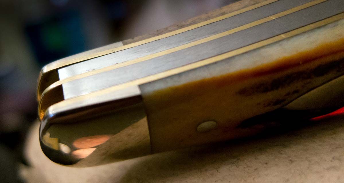

The back spring you can see is sunk down some here in this shot

Good catch there, I knew someone might ask that very question, it depends on what you are cutting, when whittling/or peeling fruit, sometimes I'll be drawing the blade's edge toward me so so the spine of the handle is against the inside of my fingers and the spine of the enclosed blades would come up against my palm.
But also in 'regular' grip you'd have the sheepsfoot peak being felt as you hold the knife. While not a big issue as you normally are not doing this for prolonged periods of time, it's just a better fit overall :)

as you can see, I also ground down the kick just a little bit on the 'pen' blade too so it sits just a tad lower to allow more clearance for the nail nick of the sheepsfoot blade once it was also lowered.
