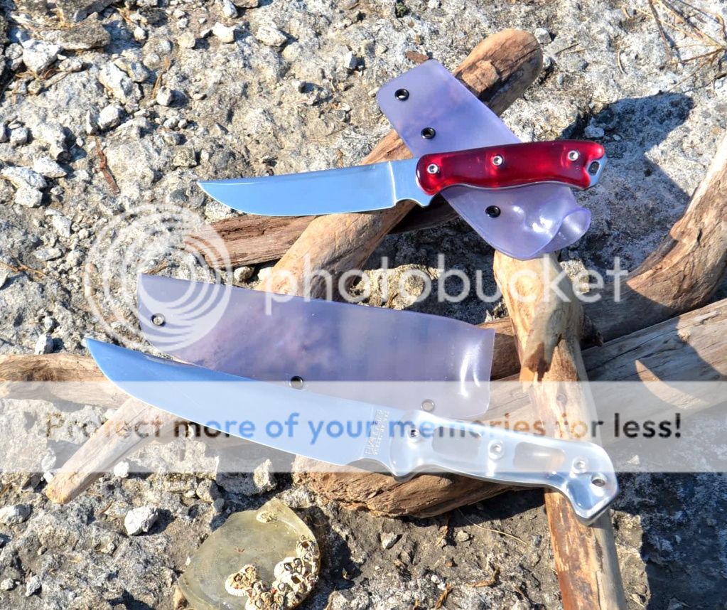

Many of you B-Heads might remember back in June I posted photos of Crystal Lite, the polished BK15 with clear epoxy scales [http://www.bladeforums.com/forums/s...ork-Meet-the-BK-15-quot-Crystal-Light-quot-!]. Well, she appears here again in the background, sporting her jazzy ruby scales, ready for a night on the town. But joining her is a new girl, with, shall we say, a little more meat on her bones! :rolleyes:
Introducing "Crystal Heavy" -- the polished and clearly-scaled BK5 that I've been fussing over since her sister "Lite" came out. They are both on their way home to reside in the kitchen drawer to be used in food prep, so I thought I'd get a couple of photos out before they left.
And here shown wearing their Holstex translucent sheaths:
That's all.

Interesting (in a good way) look. I would probably be too concerned about getting them dirty to use them lol :D. They're a ravishing pair.
It's a unique take, that's for sure. I think I like it...will have to ponder.
Could you do the clear handles with a tint / smoke, so it's not completely clear?

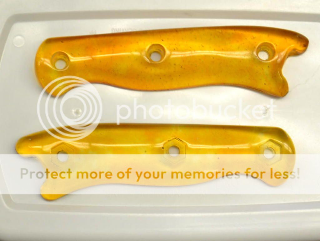

Um-m-m. That's what the "ruby" part of the Lite's scale is -- transparent tint. Comes as amber, blue, red, yellow....
Amber you want, amber you gets:

I was thinking of a grey to keep the overall clean look...but I think I like CF's idea of filling the handle with something interesting better! Don't get me wrong, I like what you've done. I'd probably only be able to keep it on display, though.
