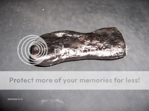

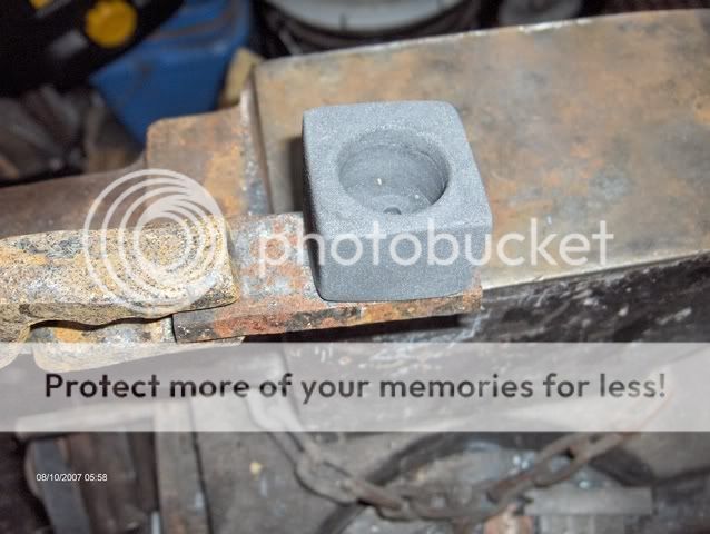

I have $4 worth of nickels in a crucibul all stuck together with flux but couldnt get them hot enough to melt. I guess I need to turbo charge my forge and try it again.

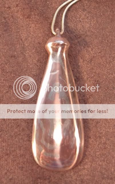

I think I read where due to increasing metal values that the metal in a nickel is now valued at about 7 cents. Thats why you are not supposed to melt them down. Pennies "bullion value" is a bit over a penny and everything else is way under the monetary value.I believe nickel 400 is the same 75-25 mix, expensive though. Nickels may actually be cheaper. I use a material that is 60 40 mix and it looks really cool. Takes a blue hue when polished well, and holds up really well. It is cast so you can see some of the casting crystal growth. You may also look into a 90-10 mix used for propeller shafting. Much more scratch resistant and much harder to work. Monel is the trade name for cupra-nickel.
