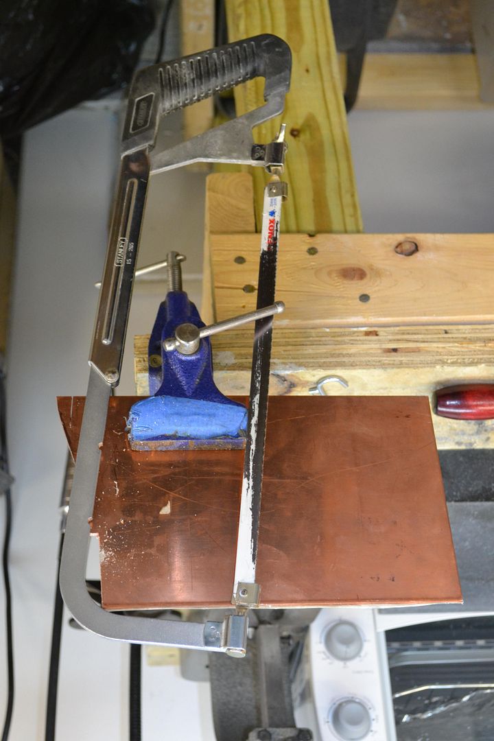

I made a copper Menuki, check it out!
What's a Menuki? handle ornament under cord wrap. It goes under the palm swell side of the grip, they are made for looks and purpose.
I have made a few from dinosaur bone, I thought hammered copper with a patina would be cool...
Saw out a chunk of copper

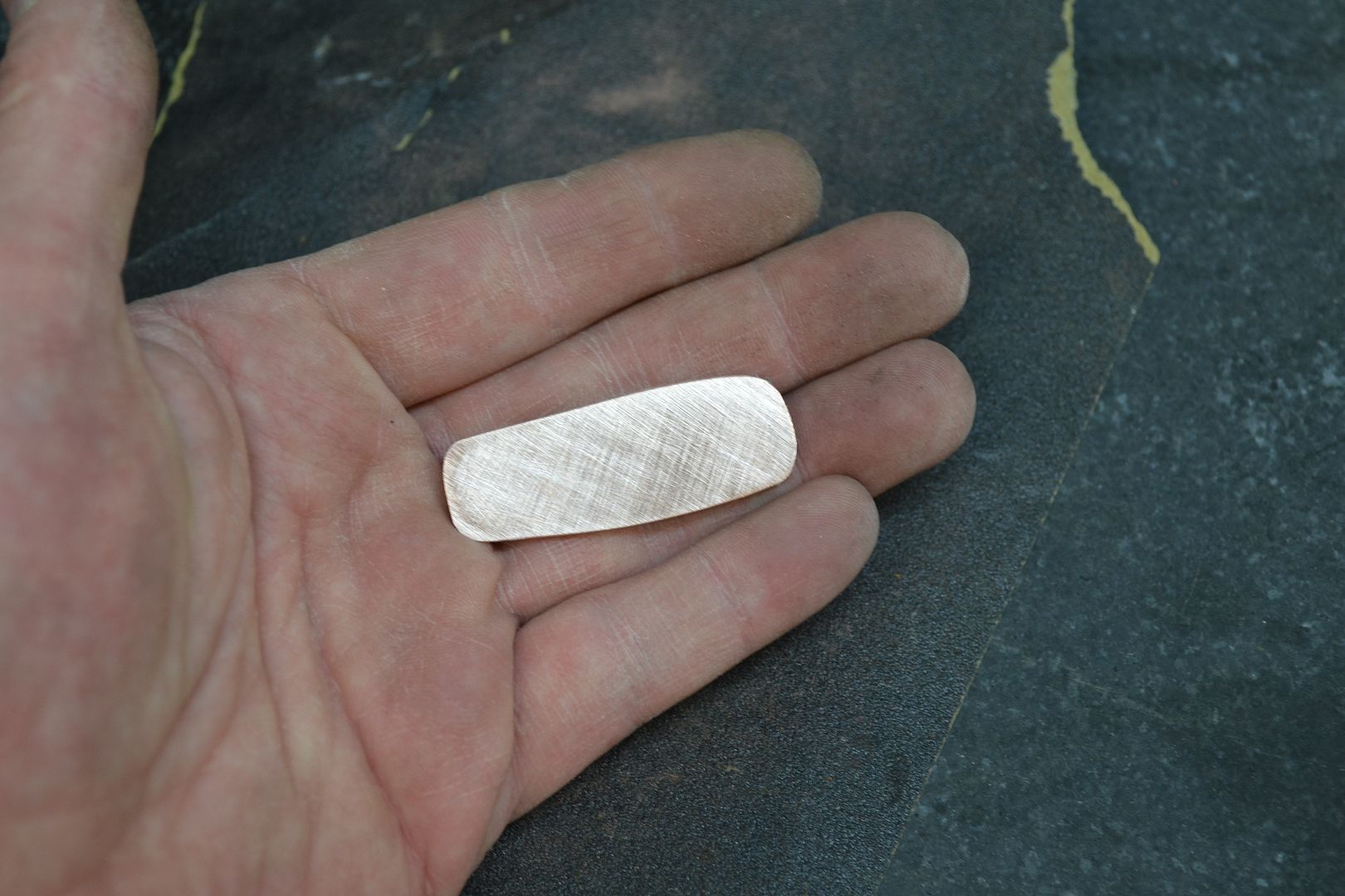

I cleaned up and beveled the edges on the grinder.
Sanded flat - I was having fun with the sanding, next time I want to make some fittings with a directional "cat scratch" pattern.

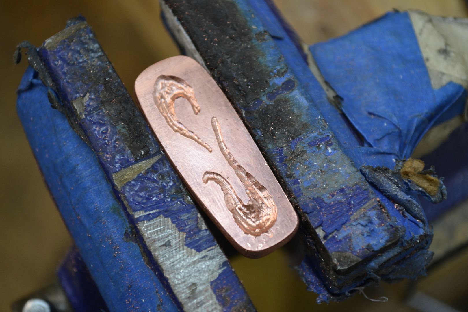

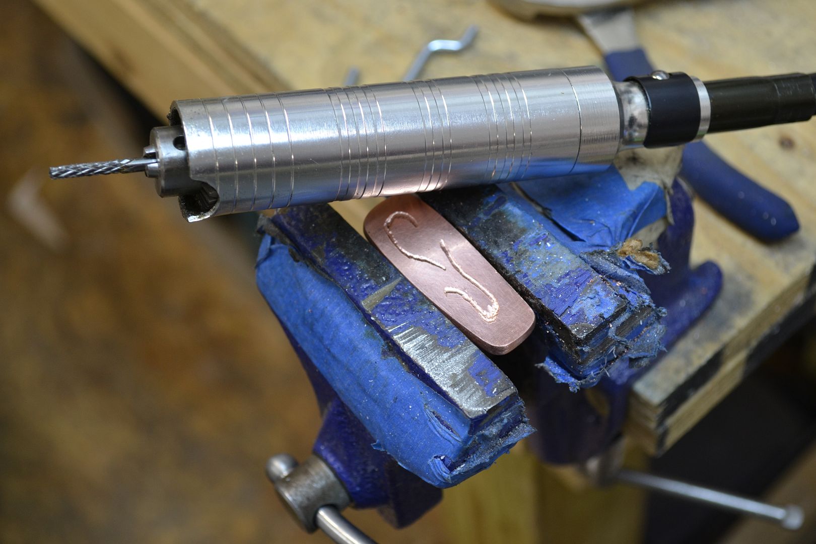

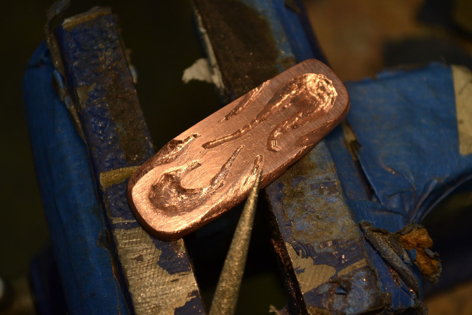

I put a burr in the flex-shaft (Foredom style... mine is a Grobet brand though) and did some basic carving
roughed out a bit...

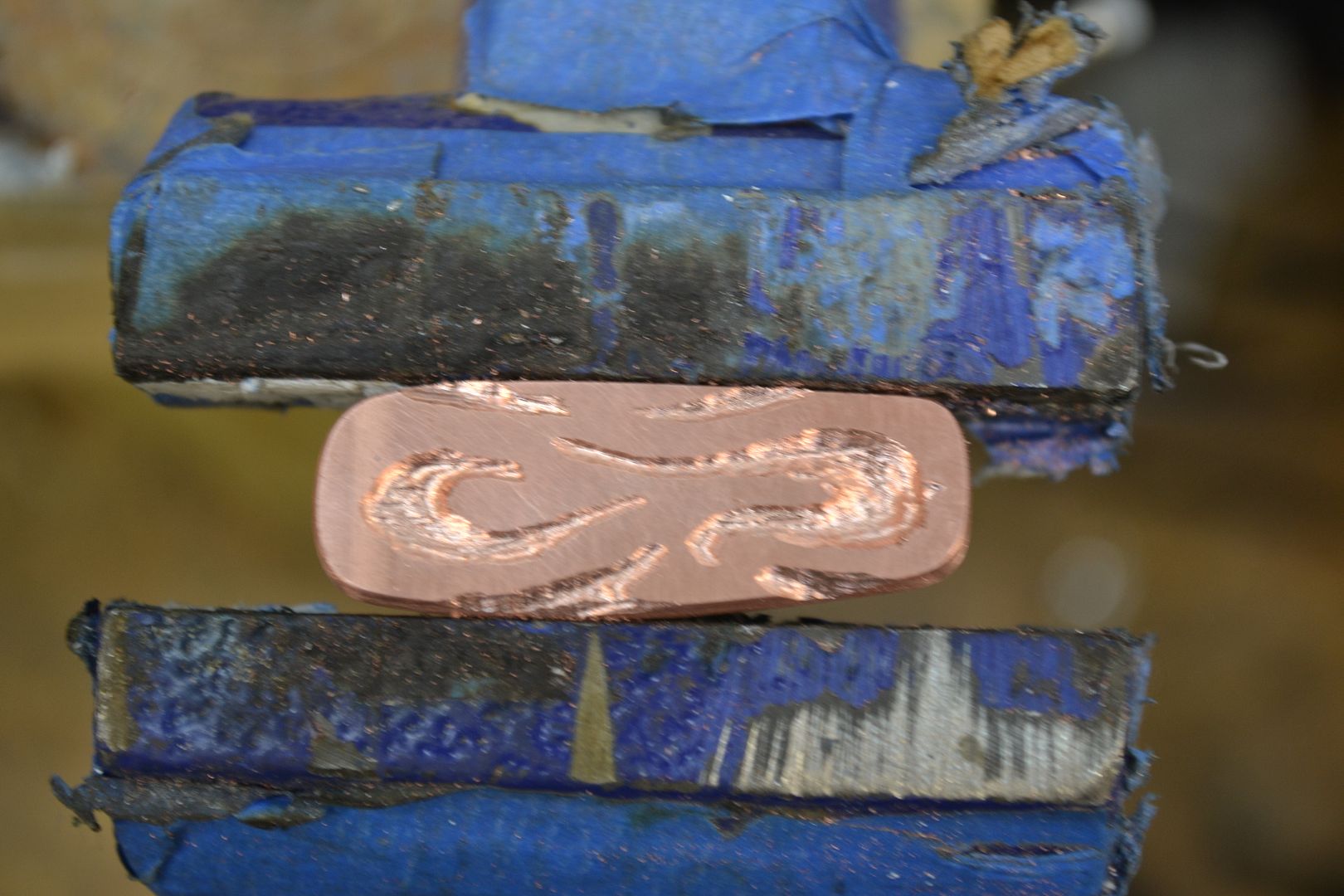

more grinding
filework - this takes the most time
More filing was done - I did a lot of sanding too but more for shaping than finishing, this gets beaten with a hammer next!
I have to admit... at this point I got a bit carried away and forgot about pics!

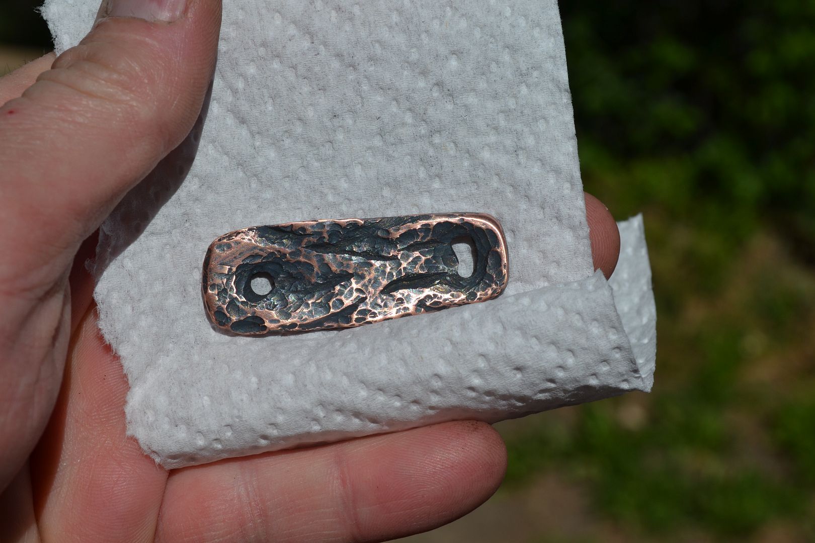

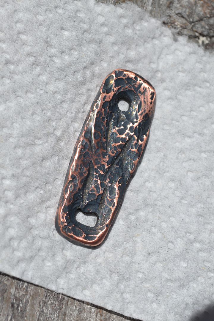

I sanded a ton more, drilled some holes, filed a ton, sanded a bunch more then hand hammered the piece. I used a tiny ball peen hammer, the hammering is lots of fun as the metal really moves. My point of the filing/sanding was to provide a landscape for the hammer to move around and really shape the piece. The hammering also hardens the copper a bit.
After that I used a liver of sulphur solution to blacken the part. Sanding at 800 then 1000 grit was the last step... I did that to bring out the hammered pattern.
