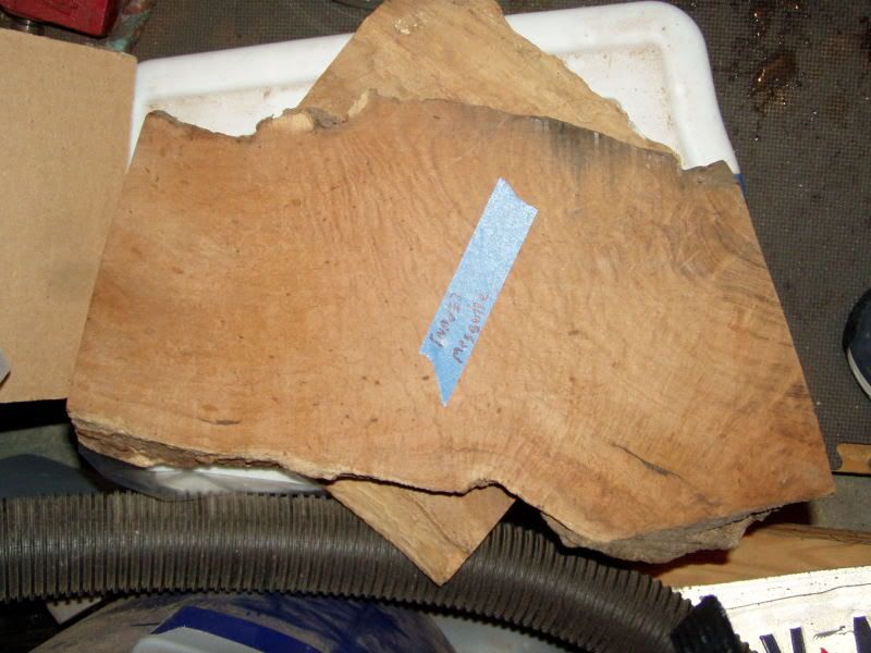

People have definitely used it. I've seen it used both stabilized and natural.
I've got a few handles worth of mesquite burl that I may decide are ready to use in another year or so.
It's nice material, especially the curly stuff. It's easy to work with and very durable for the weight. I think the grain is a little plain-looking, but sometimes that can be good too.
It looks really nice finished with Tru-oil.

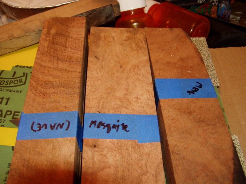

I use mesquite, and stabilize all of it. WSSI does a fine job with it.
Find an old root ball, that will be where the figured wood will be. Take a chain saw file with you, you'll need it.

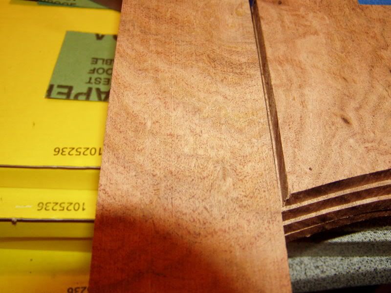

It's one of my favorites!...I like to use the small wood, limbs no bigger than 1.5" so that some cambiam is left in the mix...it provides some great contrast and the figure in the small wood can be stunning! I finish with cyanoacrylate, three coats with plenty of sanding in between. Make sure ya age dry it very well after cuttin it up into slabs....take it to the bandsaw and just look for the nicer grain patterns as you cut it!

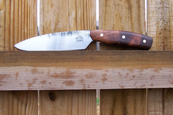

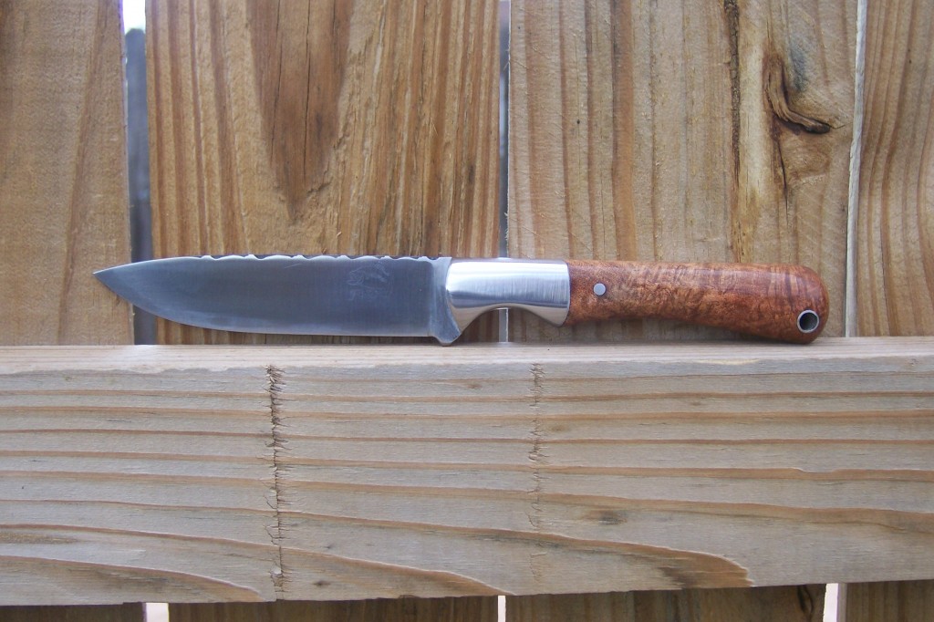

It can have a variety of different looks. All of these knives have scales of mesquite. I generally don't stabilize mine, and as you can tell, I don't use much of the plain straight grain stuff.
I use a lot, and it doesn't have to be plain. Mine get a good repetitive rub/soak with Danish oil until they can't soak up any more. There are a few sawmills around that can get you figured wood.
