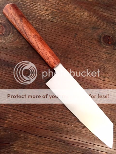

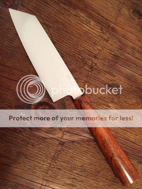

Up next is another installment of my own personal take on the "Tosagata" Santoku. What I really like about their design is the sharp corner on the spine where the tip drops. I prefer that look over the more common rounded junction. One of the things I really try to concentrate on is the edge geometry, and thinning the steel near the edge. This allow for effortless push cuts. Before I established the sharpened edge, the width of the edge was around .004", give or take a thou. Really hard to say exactly how thin it was at that pre-sharpened "apex", but to give you an idea, 0.010" is a full 1/8" above the edge. Notice edge bevel is super tiny! It also gave my wife a cut, before it was even sharpened, while I was still working on the blade polish!
So blood has been shed already with this one. For the sharpening gurus, the progression used was 400 Naniwa Superstone, 1000 Shapton Pro, Spyerdco Fine, Spyderco Ultra Fine, stropped on .1 micron film. It was splitting hairs at 400...sharp AND refined! (all post heat treat "grinding" was done by hand, wet. yes, sir that is very time consuming). Heat treat was done in house, with a digitally controlled oven. This 52100 bearing steel came from Chuck at Alpha Knife Supply, and has seen a full normalization, thermal cycling, subcritical annealing, proper hardening temperature and soak, fast oil quench to 0°F, and three one hour tempers, for a final Rockwell C hardness of 62-63. When I try to take a pic of this style of knife, the blade looks a little larger than in real life (proportions look much better in person). We use one in our home kitchen, and has quickly become the "go to" knife. I enjoy the chef's knife, but the Santoku is special.

OAL: 10.5" / 267mm
Blade: 5.6" / 142mm (52100 @ 62-63HRC)
Handle: 4.9" / 125mm (Slight "D" profile, Mesquite wood with very nice grain structure, Watco Danish oil with TruOil, pores filled, and final wax coats)
Edge: 5.3" / 135mm
Blade Height: 1.5" / 38mm
Thickness: .103" / 2.6mm at handle, .08" / 2mm where tip drops on spine
Edge: 15° per side
