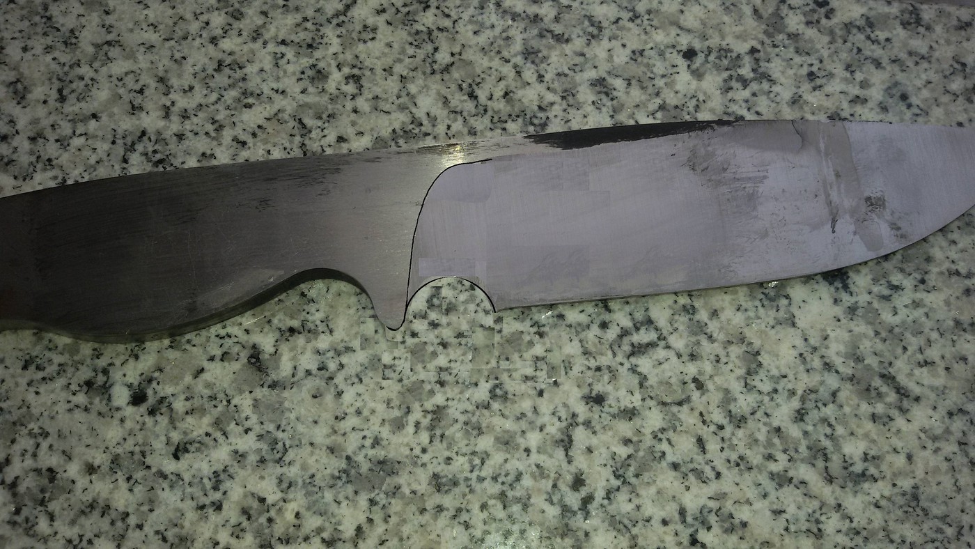

Hello,
some time ago I started to make this knife and totaly messed up the grind. Yesterday I tried to fix it its much better now it's still uneven at the top but looks way better than before. Thats the second knife I made so I'm still learing. As you can see the first time I tried to grind the bevel I came back a little bit to far and now I got some marks from the grinder that look ugly. If I just grind them out I don't think it will look good. Anyone got an idea what I can do to get it looking a little bit nicer?

In your first picture the grind went too high and you bit into the spine. To fix it you can get a welding magnet to hold the blade and flat grind that entire side until the grind comes back down.
Then to fix the bottom of your plunge you can use a file guide like suggested. Just move your plunge line further back. You could even angle it forwards if you wanted.

Also maybe some of you unstod something wrong due to my bad explanation the thing I'm worried about are just the spots I ground in with the belt back at the handle part behind the plunge. I just will do a full flatgrind on both sides now it just not simetrical cause of my bevel jig I made in 5 mins. The jig was better than the first time but still not perfect. I'm also thinking maybe my grinding table is not level. It maybe is a bit bent its just made from aluminium. I think I can just fix the grind with a better jig and the plunge should be not that big of a deal with a file guide I just harden 2 pieces of O1 and bolt them together.

I guess thats the best fix for that the choil is already quite big but I won't get those grind marks out any other way I think. I don't wanna grind the whole knife flat I think I bet I would fail with my setup because the flat surface on the grinder is not long enough to fit the whole knife at one time.

If it was me I'd take a half round file to the blade and make it a big radius. I know this world take some hand filing and everyone doing this for a profit likes to speed things up with grinders.
This is a real rough file job just to show radius shapes. If you look at the file marks you will see that the file is on an angle to get the "grind" line to 90 degrees to the blade. the small one is a 3/8" round file and the big radius is a simple 8" half round file. Looking at these, I'd go with the 3/8" if you can make it work. push your grind line back a bit and it might look good.
You don't need to do a sweeping plunge. Just do a regular plunge, just move it back towards the handle. As long as the choil goes up into the bevel a bit, it won't be sharp. Make the choil bigger and just move the plunge back, towards the handle, so it starts in the middle of the new choil. You can always move it further back. You can't put material back, as you've learned. All you need to do is go far enough back to be able to grind a bevel over the mistake. Look at the ESEE 6 as an example
