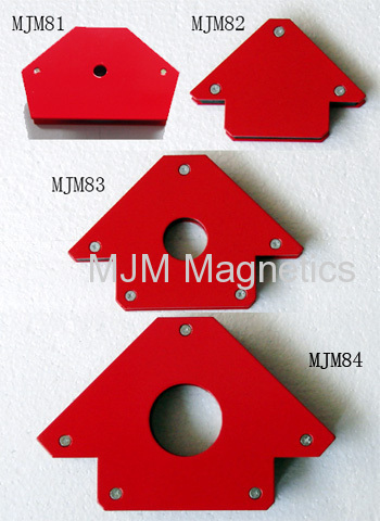

A welder's magnet is helpful when tapering tangs just for the sake of holding onto it, and also helps keep the workpiece flat and straight when working on thin sections.
James, I've been using a pretty strong magnet, but stopped using it shortly after. It started warping the blades on me all of a sudden (Kind of like the blade was 'curling' away from the platen)? :confused:
Maybe it's just my technique, but it happened a couple times actually. I'll give it a try again some time though.

I tried using a welders magnet like that to taper tangs and found difficult because it stuck so hard the platen it was hard to have any feel or control of the grind. Are you magnet guys using ceramic platens or some such?
I do indeed use a ceramic platen face, and that's a good point that I had forgotten about! Not to mention that if your platen isn't flat to begin with, you're SOL from the get-go.
Keep in mind that you can get magnets in various "strengths"... I think the one I use for hogging is rated to hold 50#, and the smaller one I use for finer work is 25#. Those numbers may be off a bit, but you get the idea.
