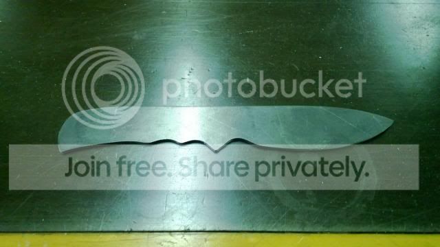

I agree around 500 sounds right for an OA setup. If it's for cutting blanks I just used a porta-band for a blank for the first time and wow! I cut this out in 5 mins -
Just clamp the porta-band in a vise and make a few relief cuts and you're set :)
