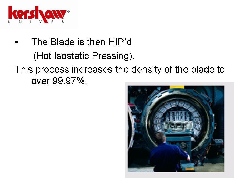

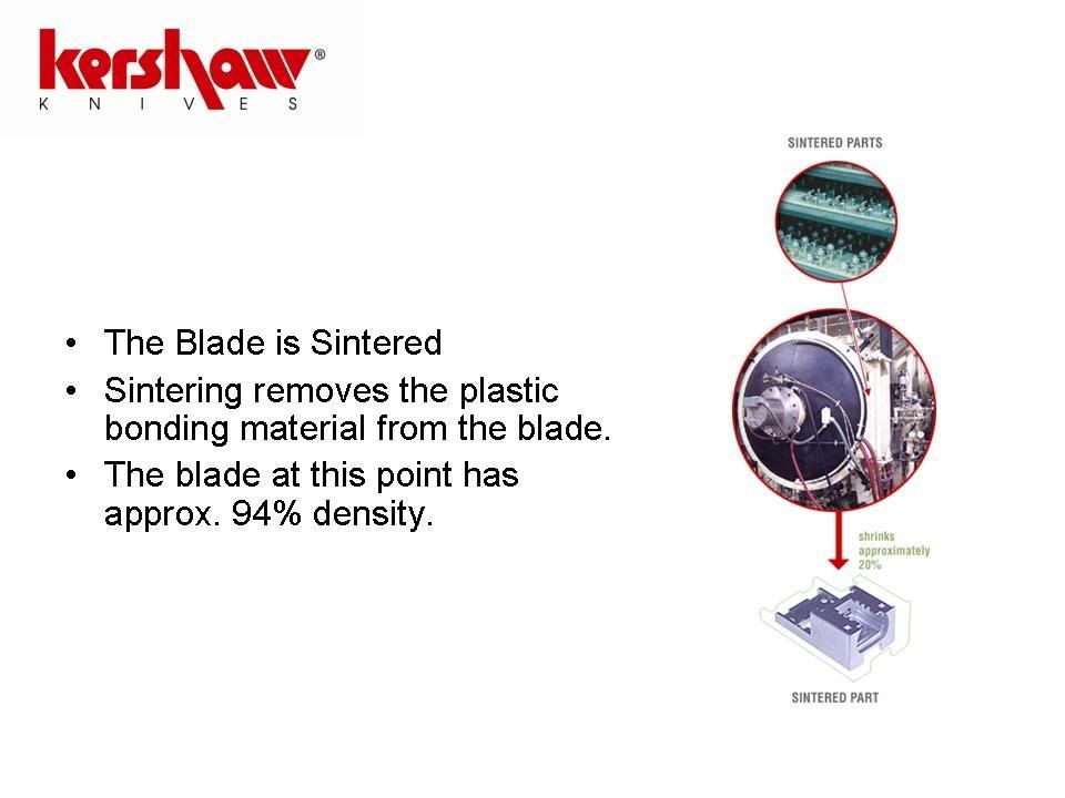

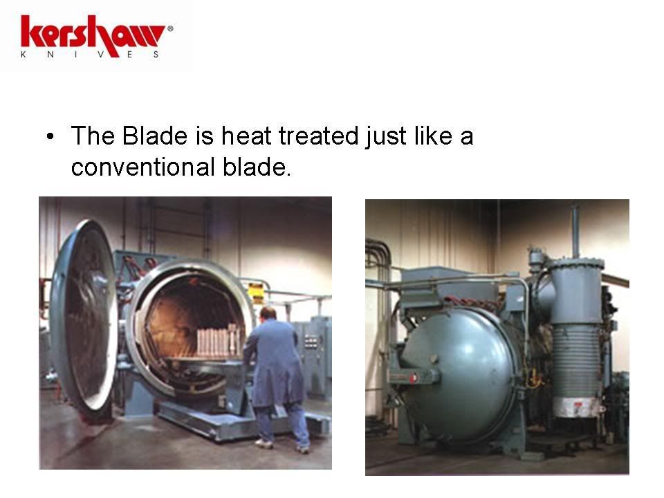

Well a few of you were asking about MIM blades, "green blades" and such, so I had Tif post them for you. Let me know if you have additional questions. Enjoy.
The above is needs some editing, as a few steps were left off.

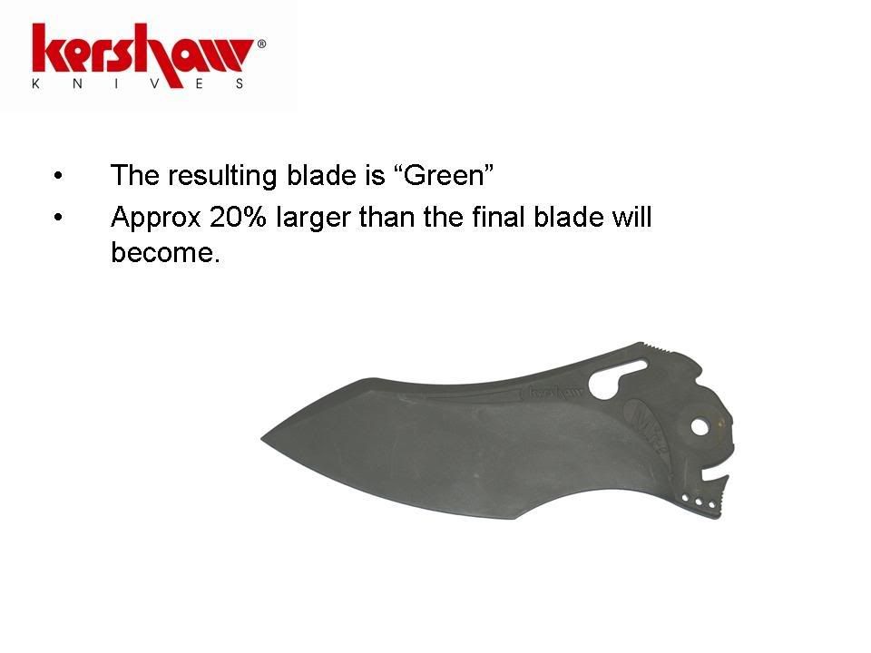

Is the translucent blade just a plastic test of the injection mold showing the flashing? Or is it a master, the mold is created from?
The matte gray blade is the "green blade", right?
So the silver blade is the HIP'd blade?
The black blade is the final coated blade?
This answer would be correct.
You are right on with your description of the blades. You can see how much bigger the green blade is prior to being fully processed. It also has the consistency of a crayon and has a bit of a green tone to its color.
