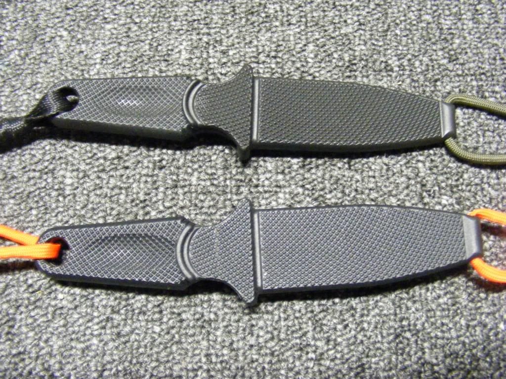

The Handle: The Necklance has a handle made of black glass-filled nylon. It's textured in a diamond pattern and is 3-1/16" long by 3/8" thick. The lanyard hole is 3/8" in diameter. There are choils on both sides of the handle, and the choils extend past the blade (on both sides) by about 1/8" to make semi-guards.

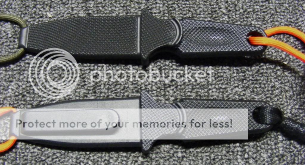

Next to a single-edged Necklance...
The handle is nice and hard, and feels like the tang goes all the way through. I haven't cut it open or anything, and the balance is right where the choils meet the "guards", but it just feels solid. Using the Necklance, at least in terms of the handle, was pleasant. The top of the handle also had the small guard, which I removed with a razor blade and sandpaper to give my thumb more comfort in use.
The handle is short, but effective enough...

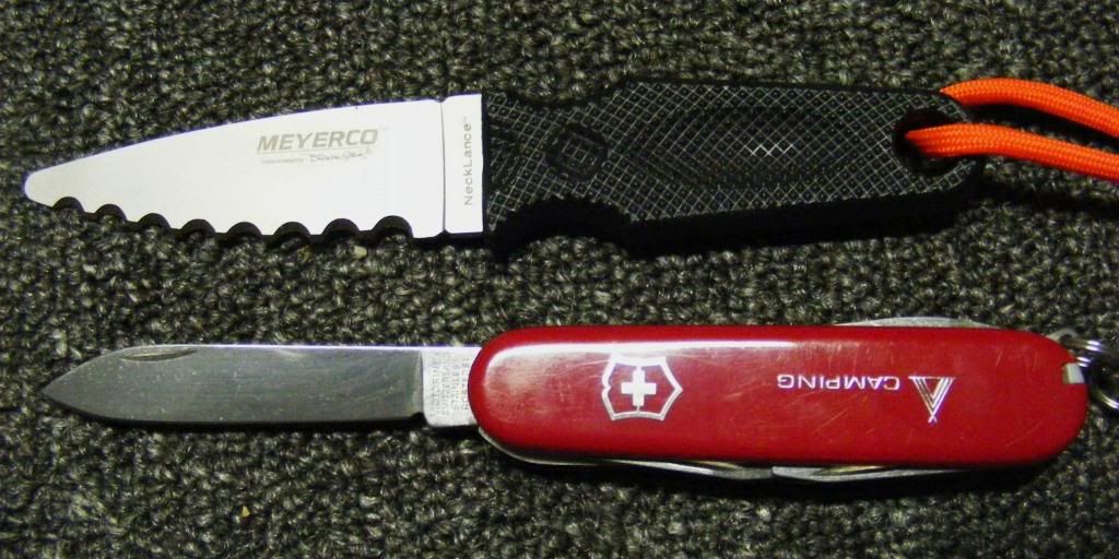

With a Victorinox Camper for size comparison...

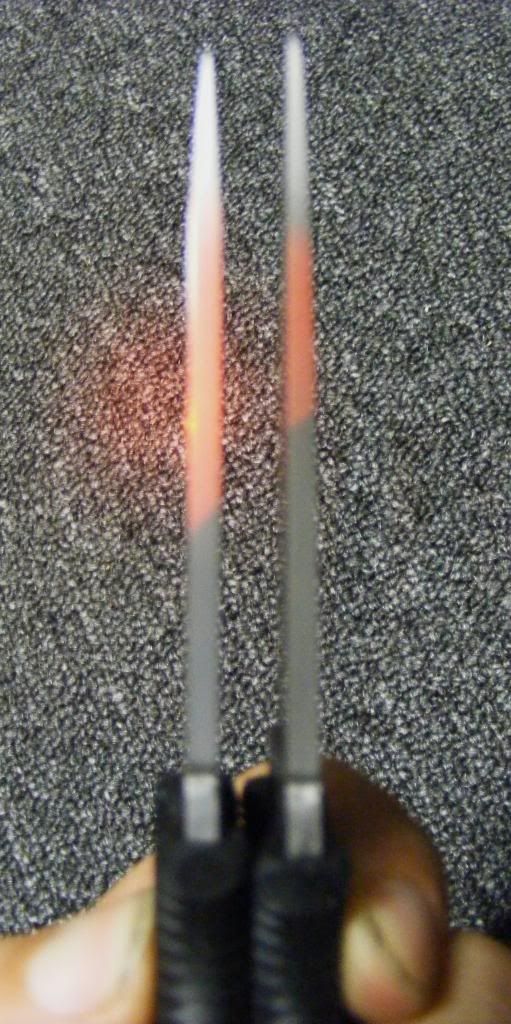

The Blade: The Necklance Rescue has a blade made of 400-series stainless steel. That's usually a mystery, but this (and my other Necklances) perform just like 440A or a soft 420HC. It will take a decent edge, but mine had to be resharpened after only a few cuts through some nylon cordage. The blade is 3-1/16" long with 2-1/2" of serrations, and is 1/8" thick. Compared to the other Necklances, it's only a tad thicker (the Rescue is on your left)...

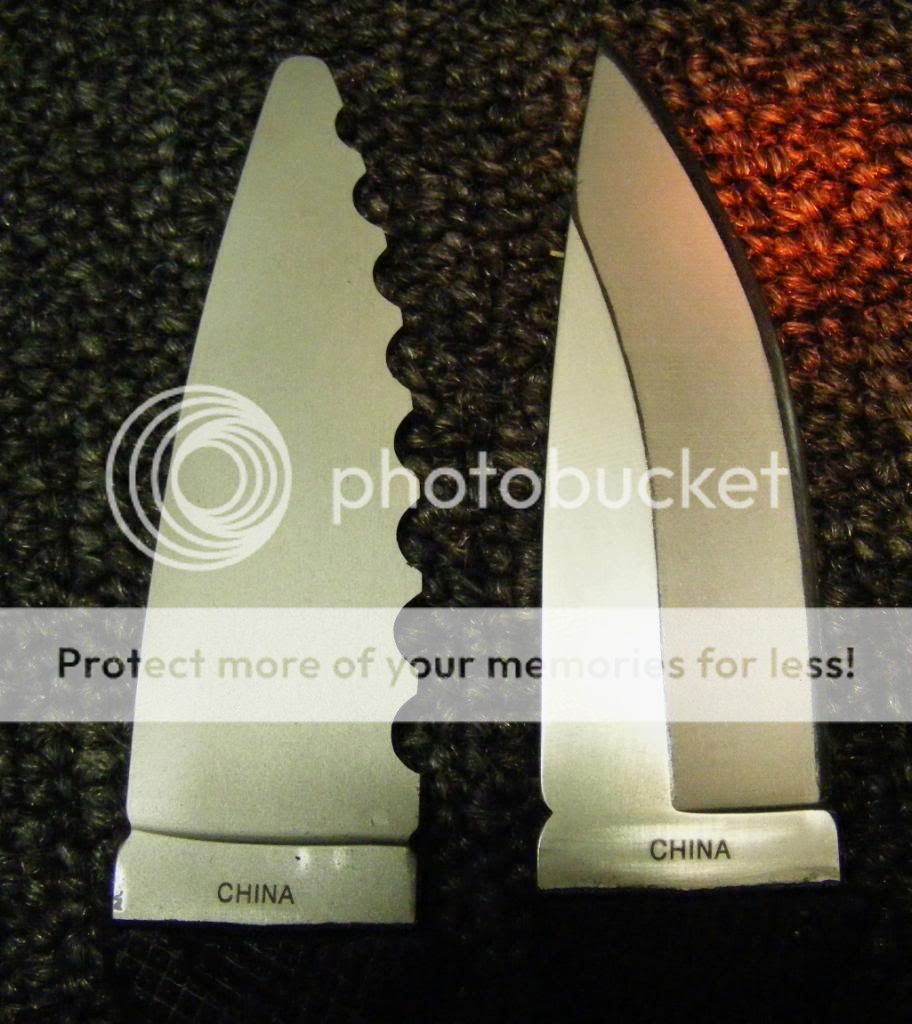

The blade is ground on both sides, but only the left side is sharpened with the very scalloped serrations. It almost appears to be a chisle grind, but in reality, the blade is centered to the right. In these two photos, the left side (first) is shown to be ground deep...
And the right side (second) not as much...
I'm not sure if you can pick it up in the photos, but it's definitely there.
The blade markings and placement are identical to the other Necklance knives, but the blade is blasted to be more matte, as opposed to the polished finish of the other Necklances...

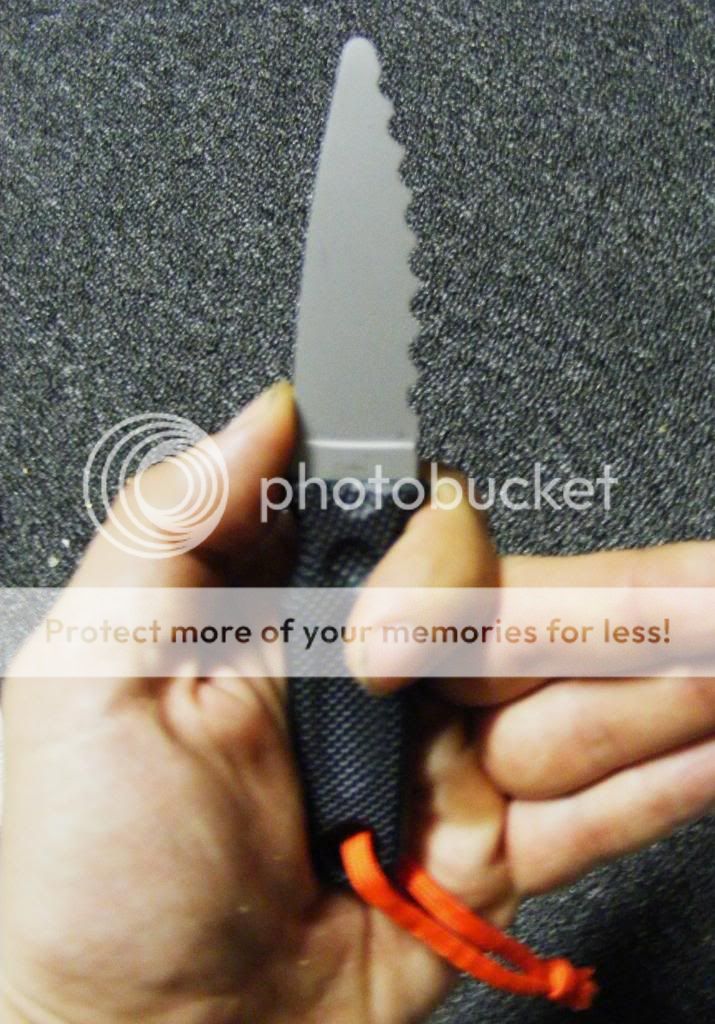

Using the blade was difficult due to the serrations; they're too far apart. I could cut nylon webbing and cord with it, but I really had to work for it. It was more of a sawing motion; I couldn't bear down because the serrations are too far apart and wouldn't slide back-and-forth. If the serrations weren't so large, they'd be a lot better. It's almost enough to keep me from buying another one of this model.
The rounded tip was thin enough (and pointed enough) that you could still injure someone by poking them. Perhaps when sliding the blade between their body and a seatbelt. Maybe not a full-fledged thrust-type injury, but they'll definitely be in some pain and will probably bleed a little bit. The tip is also not suited for prying due to the thinness, and forget about using it as an improvised flathead screwdriver.
