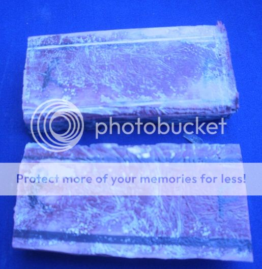

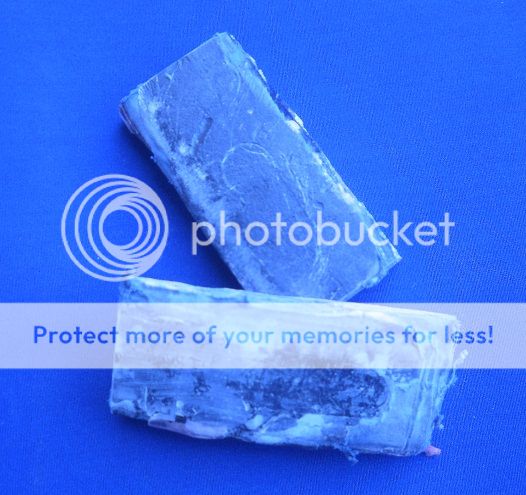

My first attempt at making micarta for my first knife.
Its 2 old T shirts in red and navy blue. The red was cotton and the blue was Reebok's Playdry material.
Standard fibreglass resin + hardener. Pressed it between 2 planks of plywood for 6 hrs.
Had a little misalignment due to slippage but I can still cut it get all the layers on the scales I am making.
Hope it works out :D
