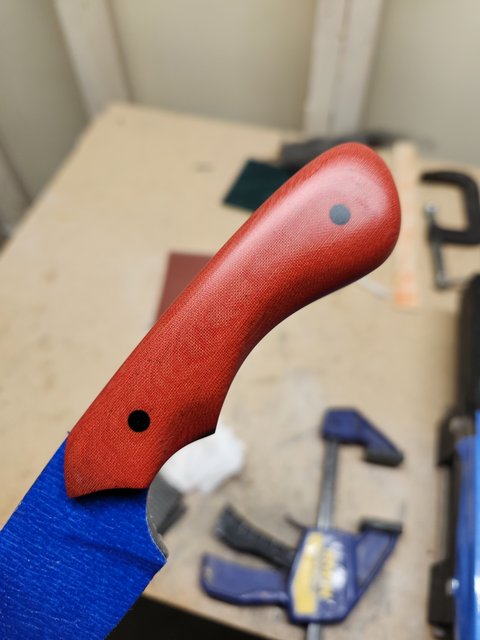

Greetings everyone. I am in the process of finishing a linen micarta handle, and I was hoping I could get some suggestions on how far to sand it. I typically take my handles to 1500 then buff, but I seem to recall reading somewhere that some people don't care for micarta that smooth. I don't use micarta very often, so I would love to hear from those that do.
Thanks,
Travis

Thanks everybody. I decided to sand up to 600 grit, then a light oiling. It's smooth, but not so much as to create a grip issue.
