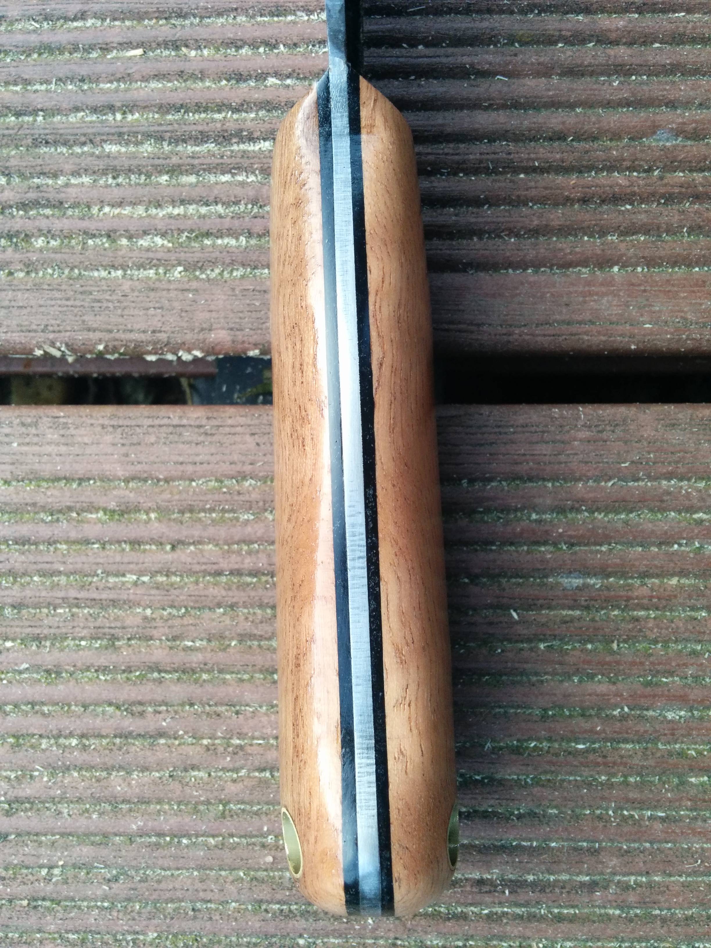

I've used felt as a liner material before. Just soaked it in glue. Here are my results:
I know it's not Micarta or G10, but maybe you could give it a try.
