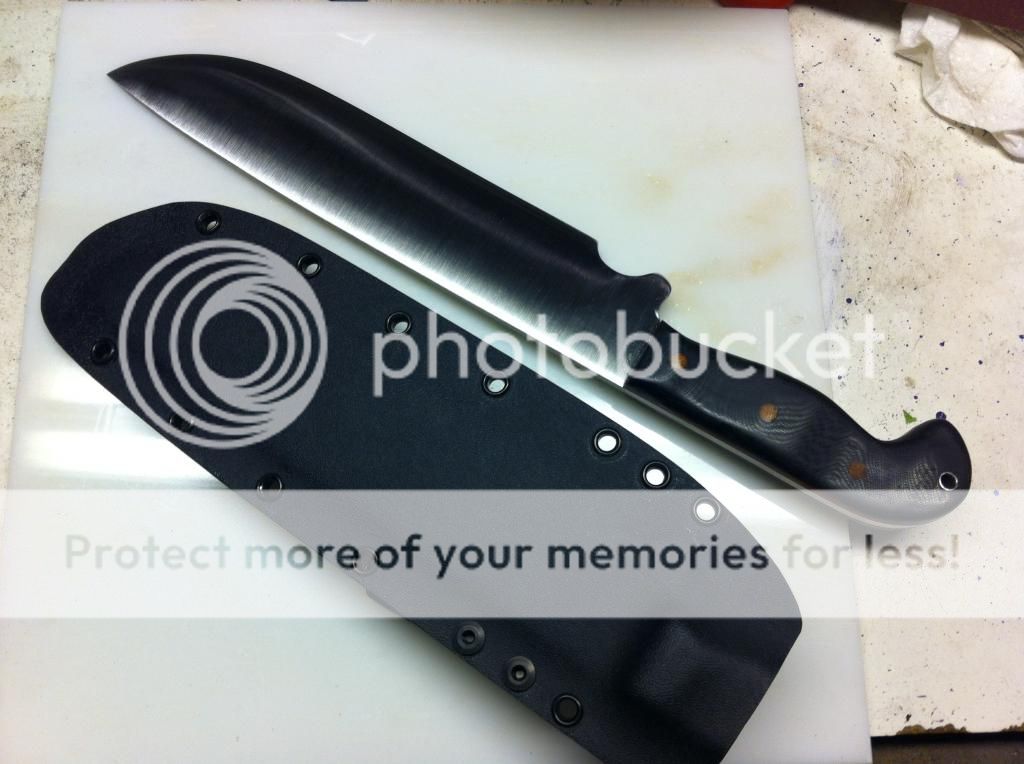

I got some micarta liner material in from Mcmaster-Carr and it looks really good. Thanks for the info. Just finished this one with it last night:
in a couple of the pics the handle is shinny from WD-40 and the others are dulled from being in hand.

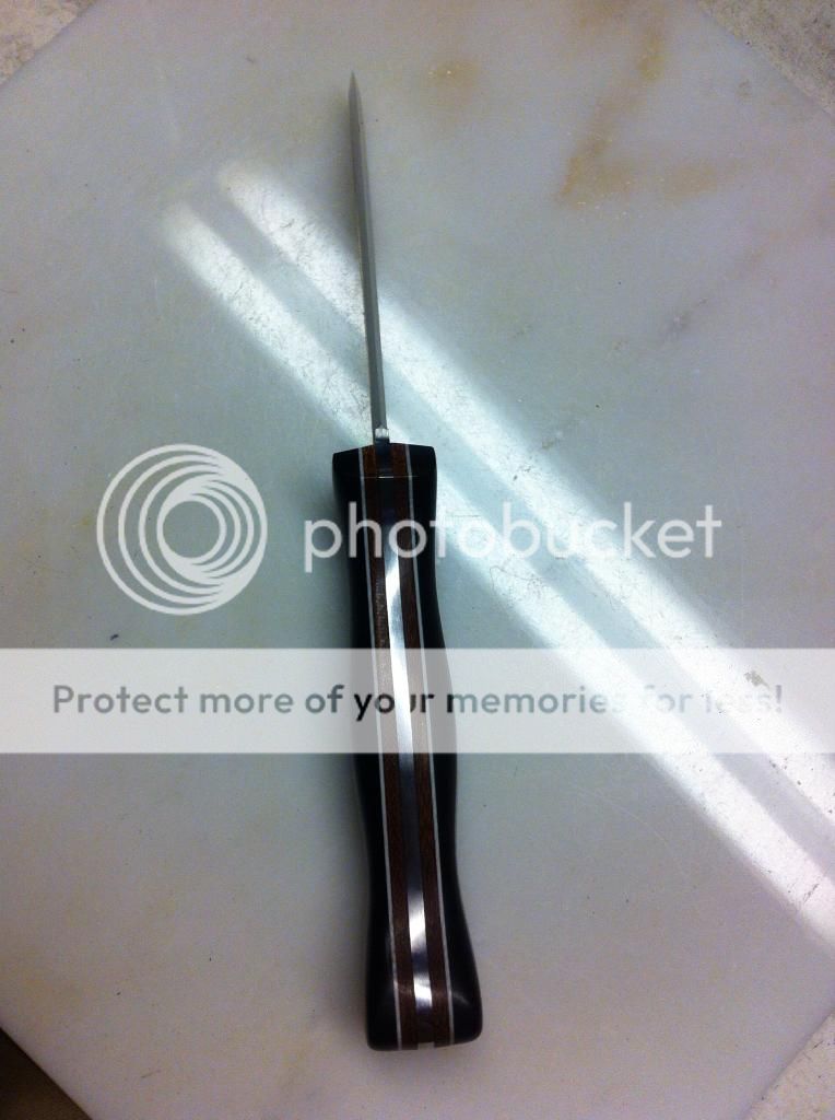

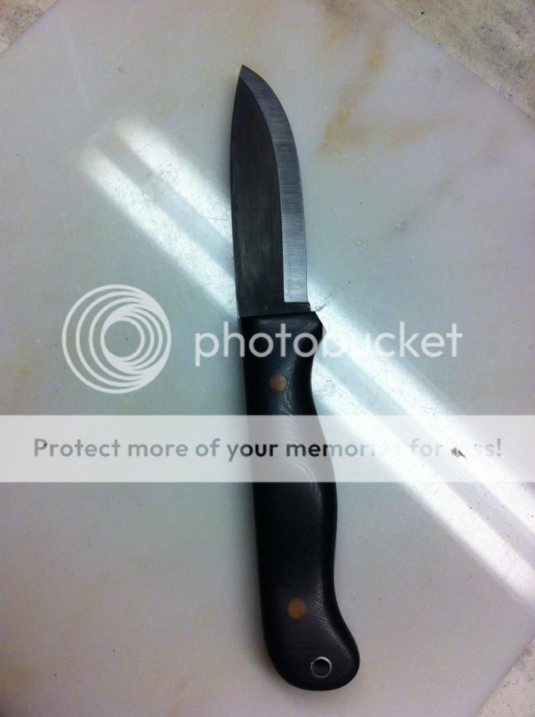

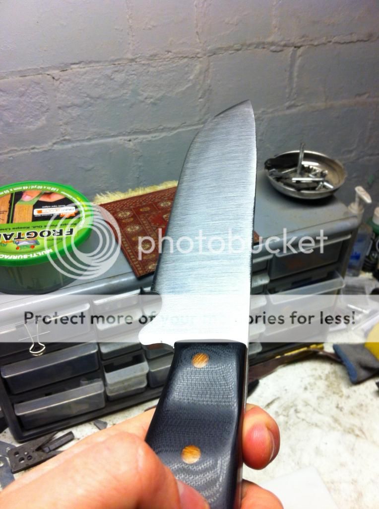

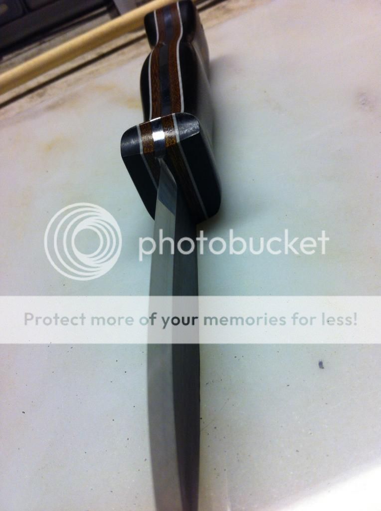

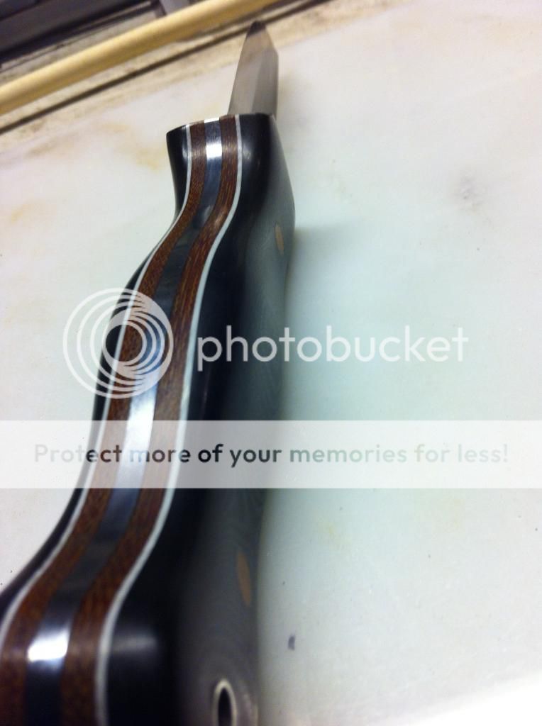

I used the white G10 liner between the black and natural micarta and it turned out great. Thanks a bunch for the help everyone, I really appreciate it. Here's a few pics:
Nice job. That one looks great.
