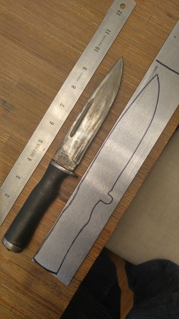

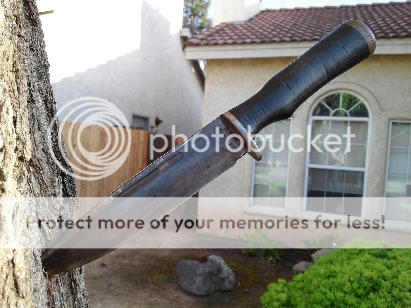

I had a question regarding a possible handle conversion. I recently acquired a Cattaraugus 225q. It's is pretty good shape--even the leather washers, which is pretty rare. However, I am pretty sure the tang is a bit rusty/ needs cleaning, and there is a little wiggle in the guard. I was wondering if anyone would be willing/able to remove the handle, clean up the tang, and replace the handle with a micarta or hardwood one? The original guard can be kept and reintegrated into the new handle if necessary. Keeping with the original handle dimensions/ style would be fine, except the new handle could extend to the end of the tang, minus the original butt/ pommel. Please let me know how you'd plan to attach/secure the new handle, and whether or not a lanyard hole could be added to the end.
Tell me what you think, what it may cost, possible turn around time, etc. Thanks for you consideration. Here is a pic of the knife (fixed blade):
Hmmm... I did a stacked leather handle on mine. Since I don't have a mill, making a 2 piece handle is out.

Looks like yours has a butt cap that mine is missing. If you can get that off, disassembly is easy. The tedious part is cutting out leather squares with a hole in the middle and slopping epoxy between each one as you stack and press.

I do flat chisel grind almost exclusively. I run a 1/3hp 1x42 grinder that isn't capable of hollow grinds.
