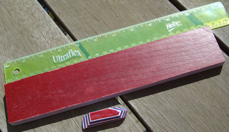

therron258...Since I'm getting ready to sell a bunch of micarta for me I use only quality paper and West Systems hardener and resin which is expensive, it does keep all my whites white, sorry I know nothing of the Bondo Brand can you post any photos or links? Here's a link to what resin and hardener I use

therron258 In the red, white & blue pictured there is 4.5 oz in paper and 3.5 oz epoxy in that finished chunk but what I yet don't know and I'll have to figure it out by keeping track is how much epoxy I use while making 1 since a lot of it gets pressed so I'm probably using way too much
