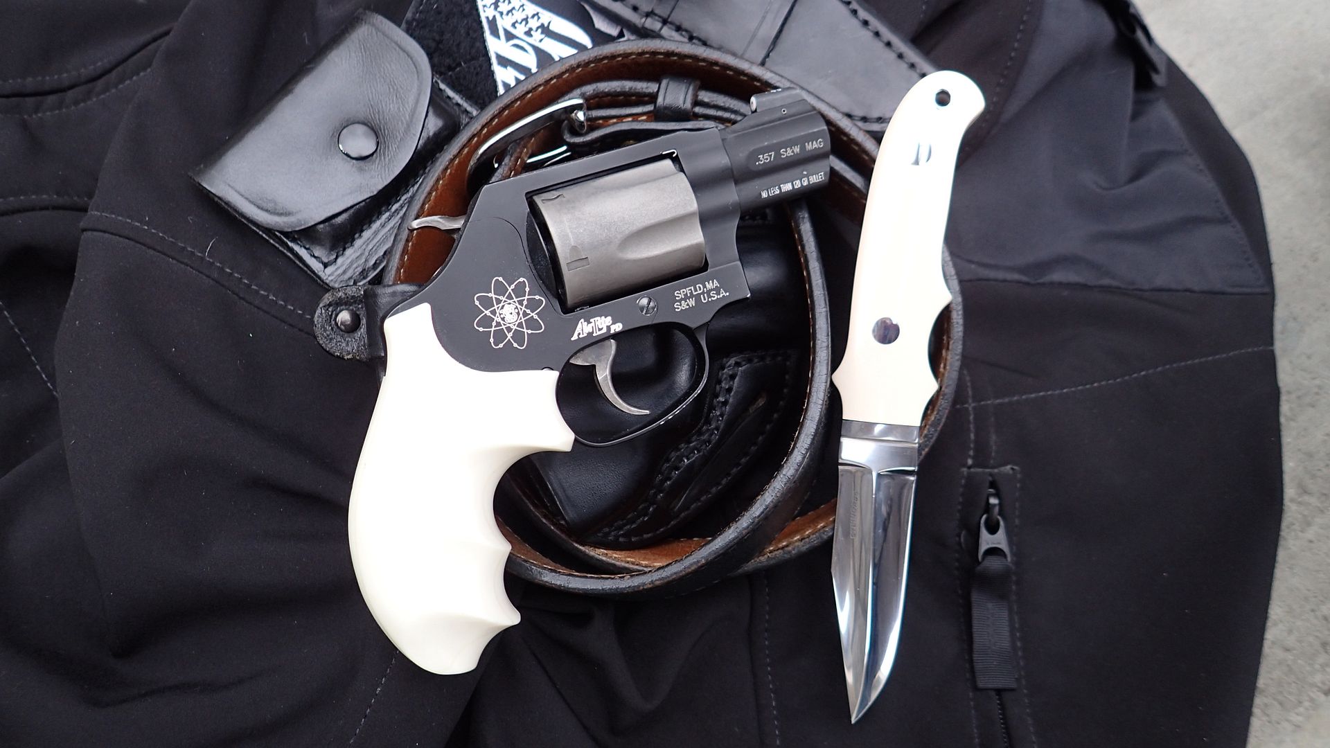

I will update this with pics of my paper micarta.

I find that paper micarta also seems to more readily take on a smoother texture with a higher “polish”
Linen and other cloth micartas seem to take a more textures surface generally.
I have paper micarta that will outlast me. I have no qualms with it's durability.
