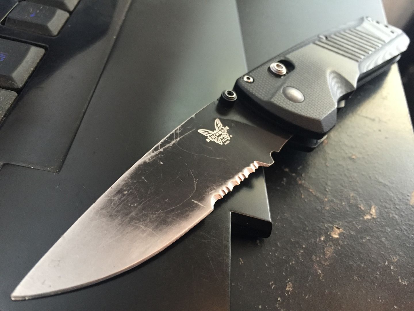

In my experience G10 feels harder and smoother. Micarta feels grippier. Really depends on how the company textures it. But imagine how fiberglass would feel as compared to canvas grip wise. That said G10 can be made very very aggressive, so aggressive that it will shred your pockets (Benchmade Triage is notorious for this). Seems like if micarta is made in the same way it will loose its aggressiveness a tiny bit quicker since it is a softer material, but already having a "grippier feeling" it doesn't need to be made aggressive like G10 in the first place. White G10 will always look the same as the day you got it while white micarta will usually yellow over time. Micarta usually feels a bit grippier and slightly softer than G10 making it ideal for large fixed blades and survival/outdoor knives. Both are overall amazing.
Here is my old EDC in G10 that I carried everyday for 2 years and abused on a farm.
These are my findings/experience. Hope it helps!
