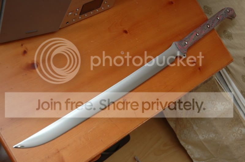

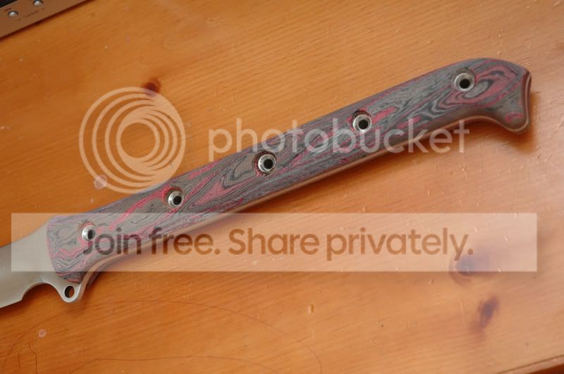

Make your own camo! Just buy the right color linen and slap them together. Ban modified his Busse AK with custom micarta handles from Shadetree Phenolics (Fod). The handle material is a mixture of carbon fiber, black canvas, OD canvas, and red linen, and some other stuff.
