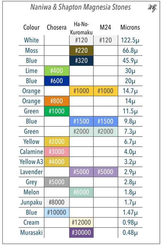

Anyone know composition, grit / micron of this stone?
Yes, here’s a chart of the shapton (HNK/M24) and Naniwa (Chosera) stones I use that I put together.
Under Chosera I’ve also included the Junpaku (Snow white) and A3 (Kagaku or Chemical) as they are also magnesia bond.
