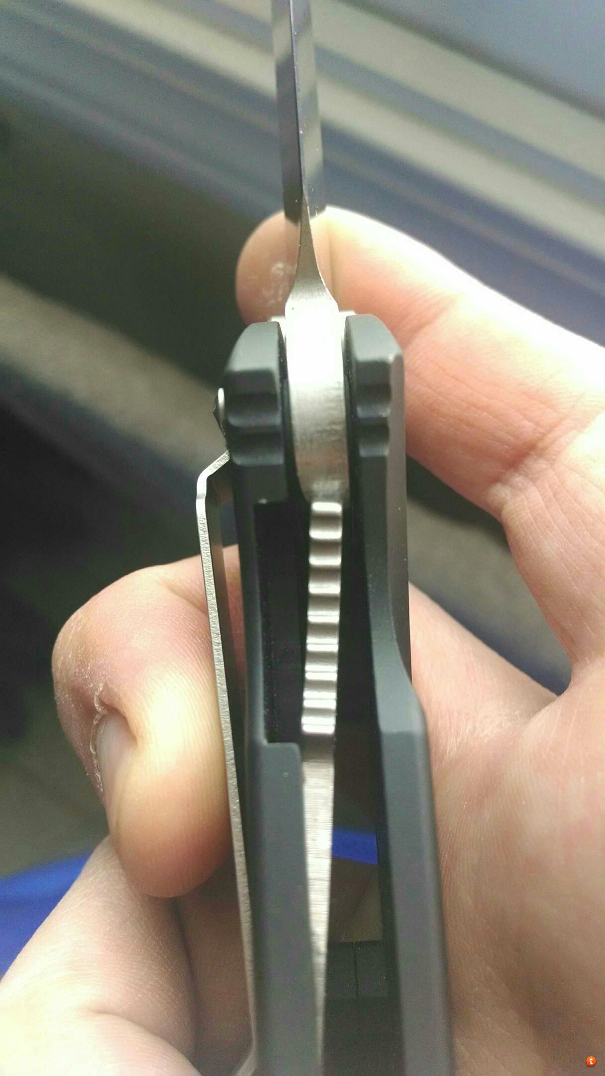

I have a Socom Elite. The newer version with the CF inserts. The steel lockbar sticks when I try to disengage it. The stickiness (kind of feels like jamming) is light sometimes and very hard at others. If I open the knife with a very hard flick, no stick. Sebenza style, no stick. Medium speed flick is what really gets it to stick. I've never had a knife that sticks at different degrees of difficulty. Tried graphite, been trying to wear it in, but no luck.
Anyone have a clue on what could be the issue?
Wow that lockbar looks really far over. I'd say send it back, but Microtech don't have the greatest warranty service.
Exactly what I thought too, but a lot of Socoms that I've seen have a late lockup. It's like 90% but it is still solid thankfully
Send it in to Microtech. Their warranty service is on the mends. I sent them my Socom Delta and I have nothing but good things to say about their service. Mine was covered under warranty.

I've just had an experience with another liner lock where it had late lockup and was sticky, when the stick went away finally I had vertical blade play.
Also I didn't think steel liners had sticking problems like titanium liners do. Maybe someone could enlighten me.
Me neither. I thought only Ti stuck because it isn't as hard as steel. Never ever seen this with steel on steel engagement.

I beg to differ. I happen to own 3 Socom Elite and Delta knives. The Elites have a fixed lockbar, that is the way they open on pretty much ALL of the newer models. It may look a certain way, but that is how it was made, and came from the factory I assure you. Here we go again with assumptions. Before stating something as matter of factly, you need to always try and leave your self room for error. especially when discussing things with limited knowledge of the topic at hand.

Correct me if I'm wrong, Rev...but isn't there a little tab on the lock bar that will only let it advance so far...or a tab on the blade? If I remember my MT Select Fire was like that as well.
There isn't one of those on the Socoms. I remember having one on my SF.

OK..Here is the fix. It is very simple. Take a pencil. Rub it on the lock face and it will be gone. That simple. I have experienced that problem with my Socom as well.

I mentioned that I did that and it actually made it worse.
