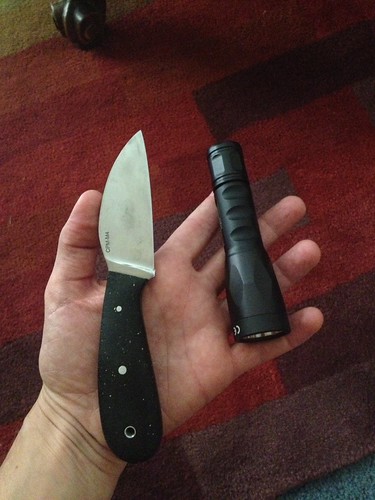

This is a small knife I EDC (and have for several years) I have used it for batoning, carving, shaving, you name it...this thing has seen it and is holding up nicely! I

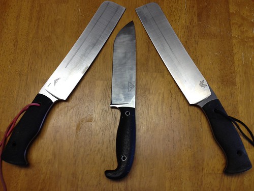

These are obviously a bit larger, but they have seen some SERIOUS use and hold edges like nothing else I have experienced.

What are the 3 knives in the bottom pic?
