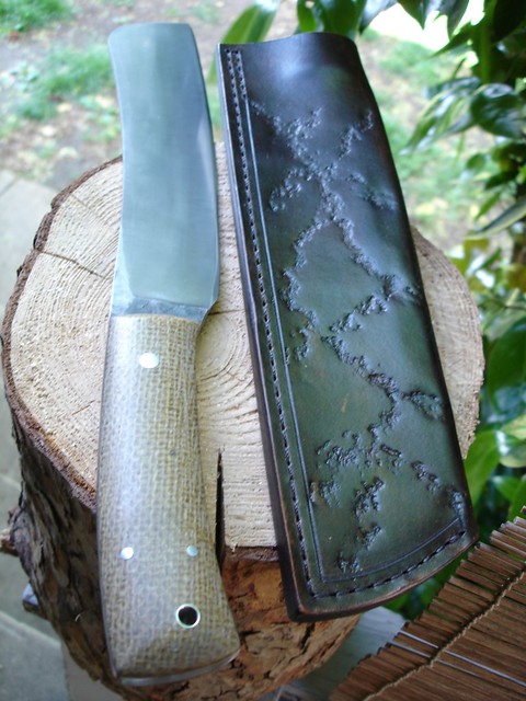

First impression out the box was "WOW"!!!
Mike obviously takes a lot of time both in design and execution, even down to the forged ring holding the belt loop to the sheath (which is extremely well-done as well). Real attention to detail here!

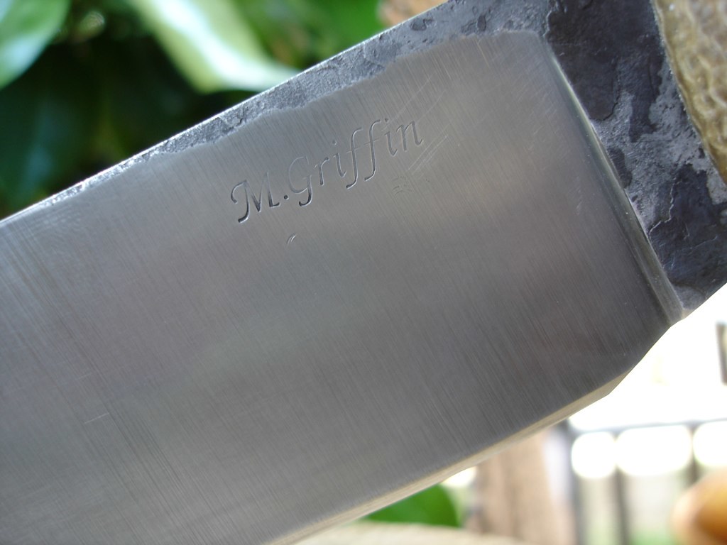

He also left a little forge slag on.
1/4 thick and it feels so light and balanced.

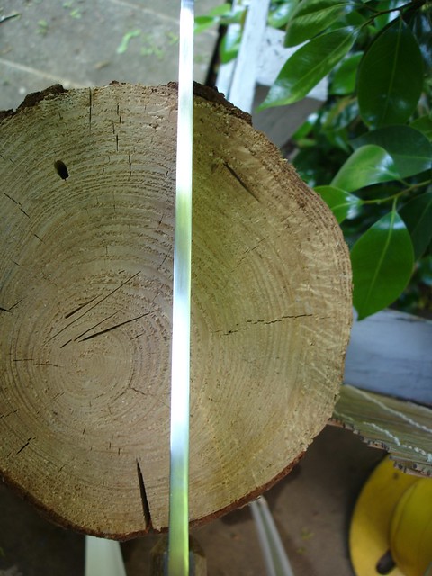

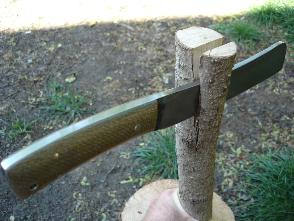

First a little battoning.

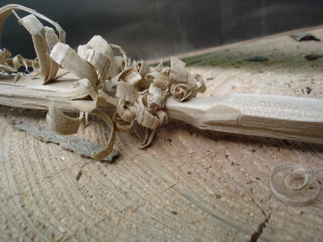

Then some feathering.
