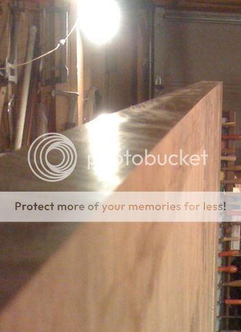

Well from a woodworker's point of view I found, what I call roundy edges to not cut accurately nor cut ultra lightly when I wanted them to. Think putting a near mirror edge on a piece of unfinished raw wood. yes I said near mirror. Here is a photo.
That's an end grain cut on a table that is two inches thick. It is made from babbinga. Ever cut babbinga and try to get smooth, chip free finishes ? Well I'm here to tell you ! The table is clamped vertically while I use a hand plane to smooth the saw marks out and get ready for finishing. Looks like it has finish on it already doesn't it ? I can't do that with round, roundy blade edges . . . oh and nothing dulls a blade faster than cutting end grain so I guess the edge holds up pretty well. That was done with A2 blade steel.
