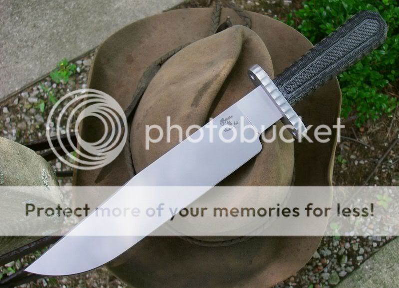

Kinda like this, but bigger?
hopefully... It should be a 9 1/2 inch blade, about 14 1/2 overall length... about 0.32 thick. I'm aiming for it to be a tad heavier than the original TM, but lighter than a BM, somewhere in that niche. Exposed full tang. Red liners. Either camel bone or black linen micarta, I haven't decided yet. Full convex grind. Integral guard -- which is one benefit of the huge initial chunk of A2!
In my head it's how CS should have responded to the challenge. I realise that this makes me the bad guy on this forum :p
You're making an A2 Battle Pappy with a full tang... i'm so all over that!
Battle Pappy Specs.
Blade Steel: INFI 58-60 Rc
Blade Thickness: .320"
Blade Length: 9 3/4"
Overall Length: 15"
I think the outline is identical to a Cold Steel Trailmaster. got one in Sai Mai, decent blade, good feel, but if your wanting a similar busse go with a Bushwacker LE version.. a great feeling blade with the .22 thick stock
would have liked to see the battle pappy, but it never came out but one show.
