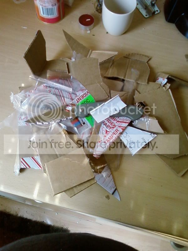

FWIW, I tested my D2 Military/SE Sal gave to me as a present:cool::thumbup: on the materials below.
I didn't put another edge on it or something. Just used the factory edge.
After the cutting the blade still shaved, but missed a small micro chip out of one scallop which was easily sharpened away.
Didn't do any further cutting with it though:o
