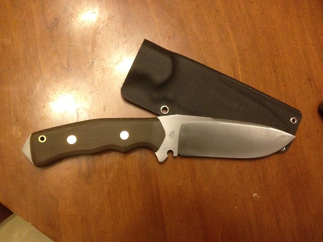

Figured I'd show off my latest and greatest creation, if nobody minds. Just finished a "military" style fighter of my own design, except for a tek lok for the sheath, which is currently in the mail.
Specs:
11" OAL (5.5" from tip of pommel to tip of scales/5.5" from scales to blade point)
Made from 5/32" x 2" 1095 high carbon steel
Scales are canvas green micarta with 5/16 brass corbies and a 1/4 lanyard tube

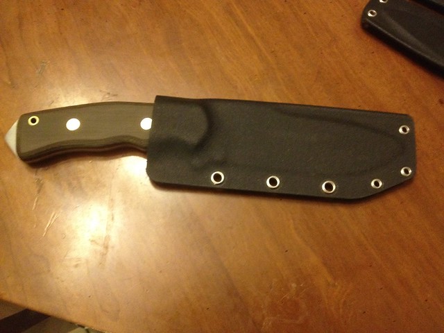

Sheath is made from Boss's "Boltaron" (spelling?); btw, I was very impressed and pleased with how this stuff formed/worked.
I included a "spanish notch" in the ricasso, though it is more for asthetics than anything. My thoughts on the green micarta/brass hardware was to pay tribute to military dress.
Overall, the knife came out much better than I could have expected. It's very ergonomic and balanced, and for a somewhat large knife, it really doesn't feel too heavy at all. the edge is relatively thin, so it makes a phenomenal slicer. I also dropped the blade from the handle slightly, in order to provide a more ergonomic angle for draw cutting. Lastly, there's some jimping on back with a slight thumb ramp for a more secure grip while thrusting/stabbing. Oh, and let's not forget the skull crusher/glass breaker at the bottom. Not to sharp or aggressive... just enough to make ya squirm...
Thanks for looking!
