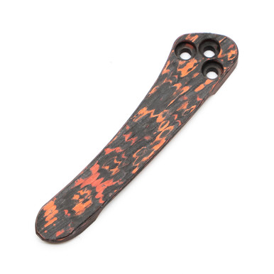

Hello dear friends,
As usually we offer the pocket clip as an optional accessory to our folders, these seldom appear in pics and were never presented so i thought this might be useful for the future collaborators making their decision easier.
Everything starts with a thin 0.14" carbon fiber strip; after the cnc does it's work we finish each clip by hand chamfering the holes for the sunken head screws, profiling the tip 'pill' and overall sanding, edges chamfering and buffing.
I also attached a short vid that will for sure explain better than words can do :)
Thanks for watching!

Nice work but you are going to find that they don't hold up to long term use. Prepare to replace them in the future.
Hello my dear friend,
I have one in my father's in law knife for 3 years now and is still as in the first day but anyhow these are not very hard to make and also not too expensive and look very nice for my taste :); i used Ti in the past (specifically bent Ti) and i do not like the look and feel and for milled Ti there is another story yet i dont have the needed machines to go that route :D
Thanks a lot for the tip - ill keep an eye on these ;)
All the best, God bless,
Bogdan

Looks great but every carbon fiber clip I've had has split at the screws
Thanks a lot brother! Haven't had this happening up until now but ill be here prepared for a swift replace if it will be the case :). I do not think it should happen, especially in a milled one where the screws part is overbuilt, but only if it is somehow over tightened.
All the best brother, God bless,
Bogdan
