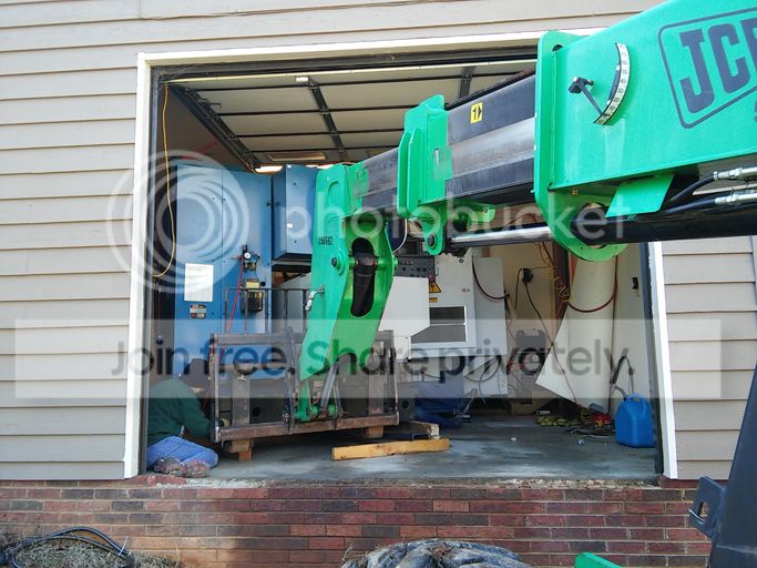

So I'd like to know....Lets say you see a nice bridgeport mill on craigslist you go and look at it and its perfect! so now how do you get it home? what do you need?(and I'm guessing whereever you put it it can't go through a doorway if were talking a full size mill)
DR...
Personally I would put an ad on craigslist asking for heavy equipment movers and you will find guys that will move them for pretty cheap, $200-$500 depending on where you are at, in my experience. Do question them and make sure they have insurance and experience moving mills and lathes and such.
A 1 horse Bridgeport weights about a ton and has an awkward center of gravity, if you have no experience doing this your perfect bridgeport may be a box of parts before it gets into your shop or worse could injure you. I've used professional services to move my large tools before and it was more money than a craigslist guy but only about 250$ per machine with a $1000 minimum.

I snapped this picture a few weeks ago while moving a bunch of machinery at my shop.
move.jpg~original
We moved:
2,000 lbs Bridgeport knee mill
4,000 lbs Gorton knee mill
4,700 lbs Yang lathe
5,100 lbs Vectrax CNC knee mill
6,200 lbs Romi minimill
7,700 lbs Kia machining center
8,800 lbs Bridgeport machining center
The three of us did this, Jo, Ray and I, with a rented off road forklift, pry bar and some skates we whipped up.
We're not particularly skilled at this. We didn't spend a lot of money. I've done this many times before, I'm not insured, and I own the outcome. And I'm comfortable saying, moving heavy things, if you're slow, thoughtful and careful, isn't particularly difficult. Assume things will go wrong, plan for it, and stay safe.
I understand people's hesitation to move heavy things, that's wisdom. And until you've done it a few times, it's scary. But don't let the need to move something heavy stop you from doing it. People built the pyramids without Sunbelt rental, you can move a little Bridgeport into your garage.
The scary and dangerous part is driving a truck down a public road with a mill on/behind it. Be responsible and secure your load thoroughly.
The Kia weighs almost 4 tons, it stands over 8 feet high and it is only 29 1/2" wide at the base. I drove that through Friday rush hour traffic through the middle of Charlotte and up I77 to Mooresville. But it was bolted, strapped and chained down (redundant) so I was safe.
