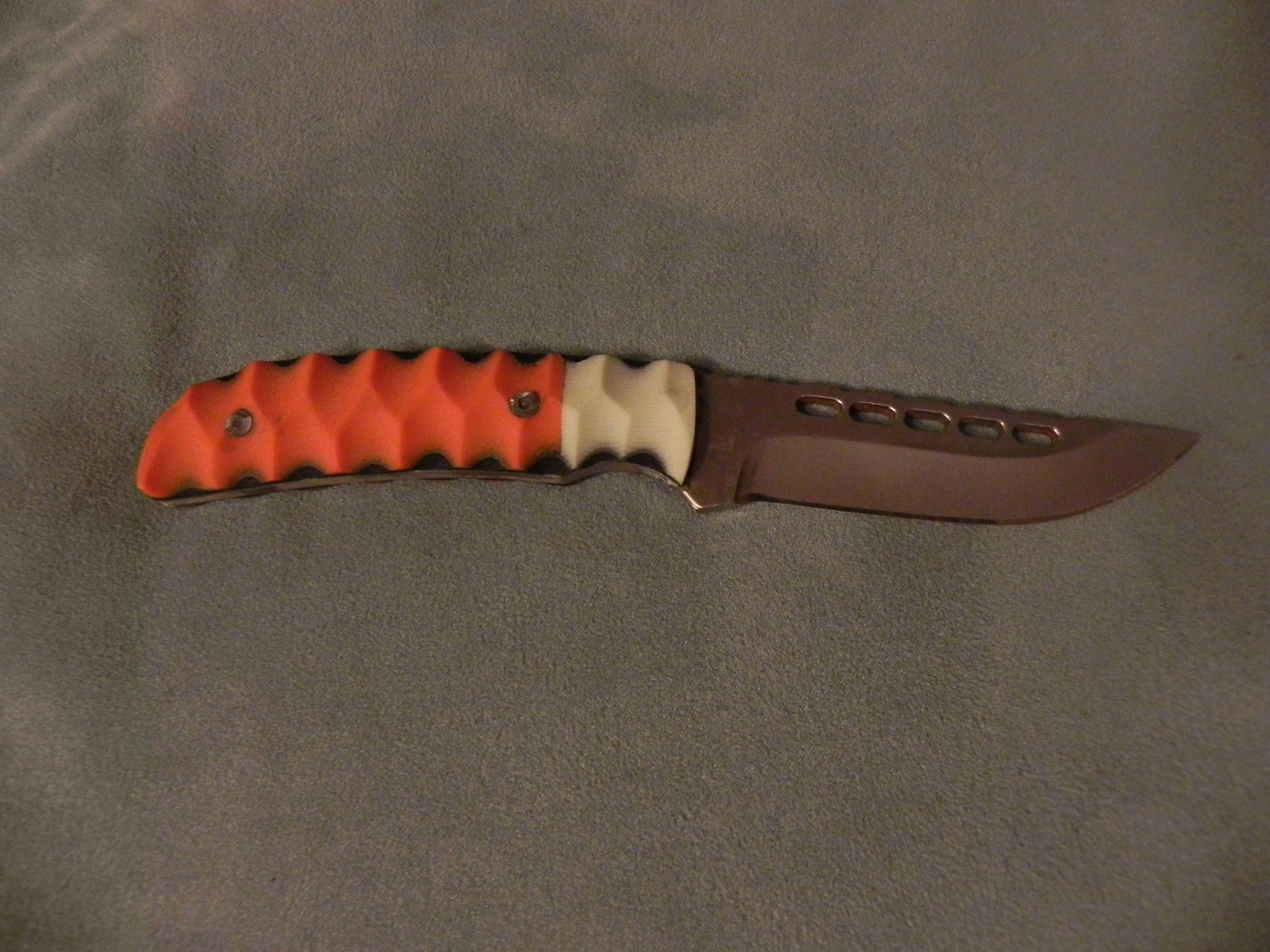

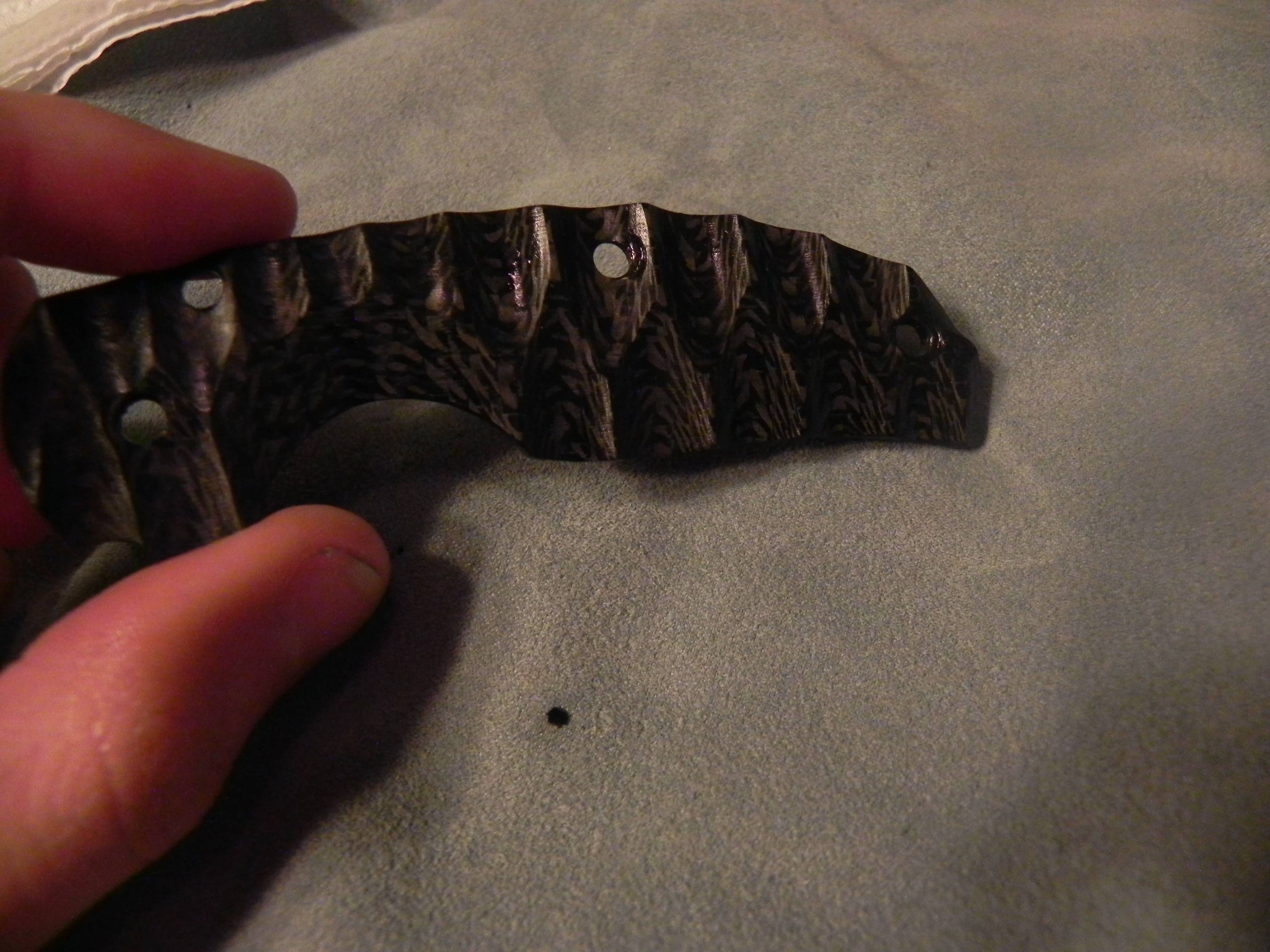

I pimp knives and im looking for an easier method to use to mill out g10 handle scales. Is there a certain bit or technique i could use to make it an easier process? Thanks for any advice!

What does the cut look like, show a picture please?
Are you tearing material up or something?
We aren't getting what you mean.

So what exactly are you thinking about doing to the scales ?
I see you've done this

Lock down the height of your drill press, and you might be able to SAFELY use a ROTARY FILE to really hog out that material fast without too much wear on expendable abrassive stock.
(EDIT) That of course is only if the pictures posted are what you are doing, if you are "milling" material, listen to Rick and the others, it isn't worth it.
