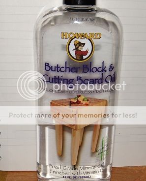

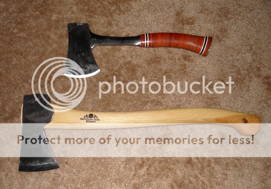

I have been using Mineral Oil made for Edit, lol: cutting blocks on all my knives lately. It works perfectly, not sticky, not smelly, not need to worry about it rubbing on my food, and no rust(almost:rolleyes:). My question is, can I use this stuff on my axe handle and have a positive affect? I'm not worried about what is better, I just want to know if it is positive?
I use BLO on my handles and heads. Unlike mineral oil, the BLO dries and doesn't leave oily spots on the shop floor where I store my axes. I don't have an answer about using it on your handle, but it seems to work fine for butcher blocks, though.

Generally speaking I wouldn't put a non-drying oil on either a wood or leather handle. It'll soften the leather and slick up the wood, neither of which is beneficial. I happen to like linseed oil cut with mineral spirits or turpentine around 1:4 as a tool handle wipedown.

I get the cheap stuff from the Wal Mart pharmacy. Can you say laxative? Works great, I've been doing it for years. It will not hurt your axes...But BLO just might be a better idea for an axe.

I did a test of BLO on a walking stick, and mineral oil on an old beater stick. The beater stick did not smell, did not have any oil drops on it, all absorbed, and it really wasn't slick. I think I'm stick with mineral oil. We'll see what long term use brings.

And note to those who said mineral oil makes it slicker. 2 days dry time is the max I have had to wait in 3 coats. And it's not slicker than my linseed oil. Though I will note that it is two different woods I am testing on. Mineral oil on hickory, and Boiled Linseed Oil on my walking stick(Pine I think).
