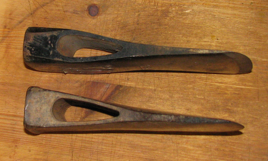

Whatever you call those old hardened poll axes these photos can give us an idea why these axes were so popular for people outside of forestry. Think about this mining photo. A big part of mining is a shoring operation - a continual battle to stop the earth above from falling in on you. A fractured rock ceiling doesn't conform perfectly to square-cut timbers. Once a timber frame was built you would have to install wedges to fill the gaps between the timber and the rock above. Or the timbers themselves might need to have the corners knocked off in places to fit to the rock.
Also, a miner might need to drive fasteners into holes drilled into the rock to secure the shoring timbers. This one tool would fulfill all those needs.
Loggers transporting logs rafts downriver used them for driving the log dogs used to chain the raft together.
Other hardened poll axes were used in timber framing or other general construction uses. The 'killing axe' found favor in the slaughterhouses for putting down cattle with a blow to the head with it's hammer poll.
These hardened poll axes were work horses for many men outside of the lumber industry. Nothing like them is made any more. It's a pity.

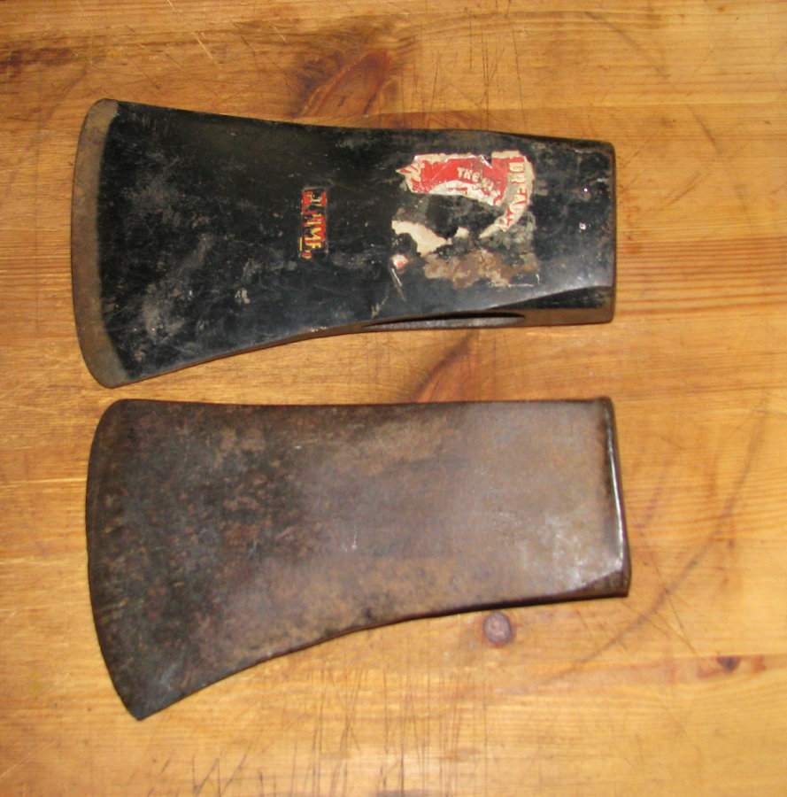

Here's another of my hardened poll axes. This one is a True Temper Dayton pattern. Surprised the heck out of me when I took a file to it. It's quite hard.
Interesting, I may need to spot check some once in a while. I sometimes see standard looking Dayton's with fairly thick polls. Not beveled, never crossed my mind. I'll start testing them.

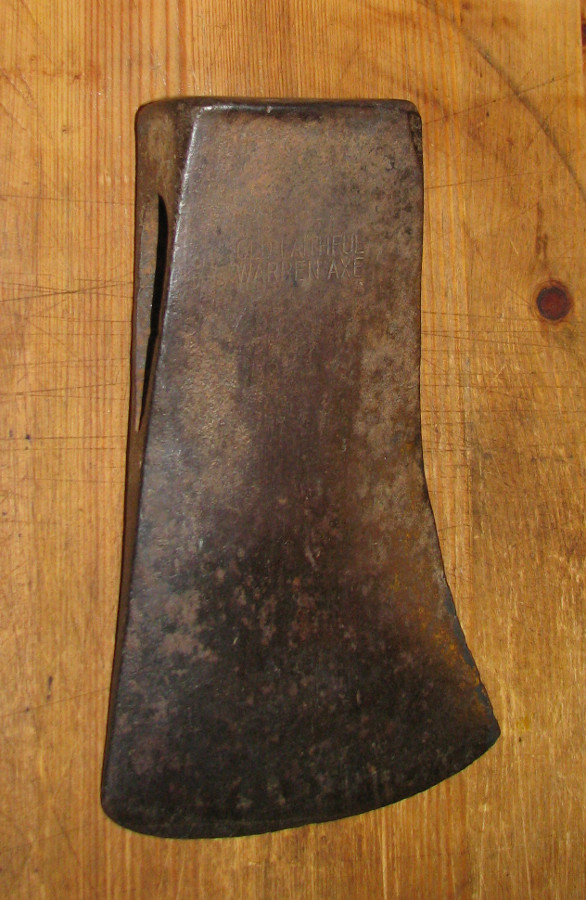

I think it's notable that the axe pattern is called "rafting" in the old American axe manufacturer catalogs, not "miners" nor "construction" axes (names that must have caught on after the heyday of log rafts). Those Plumbs are attractive. I'd like to see an example made by Warren Axe & Tool (a "rafting" axe is shown in their 1937 catalog).
Here is one Steve.
I should probably clean it up nicer but I would hate to loose the original red paint in the stamp.
