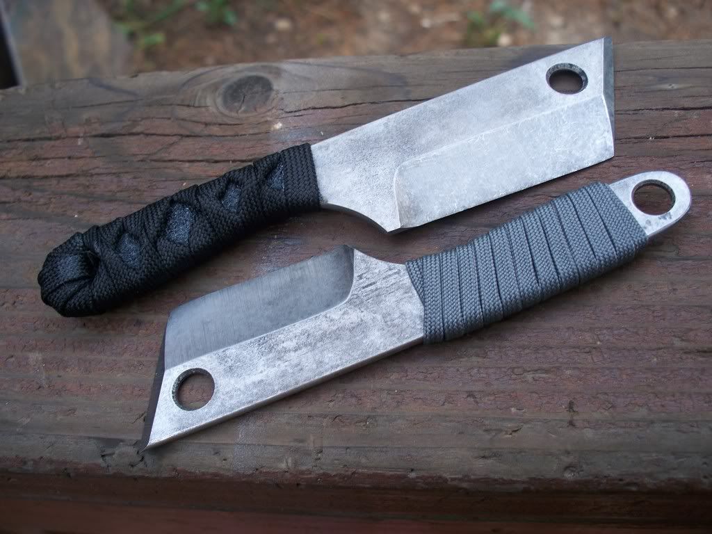

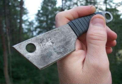

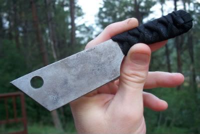

1/8" 1095 Steel - I brine quenched (water hardened) the 1095 to ensure maximum hardness before temper and more importantly full conversion to hardness.
Zero Bevel Main Grind - with a microbevel on the obverse side. ...very little cutting friction and works right or left handed.
Acid-Washed finish - looks great even with use
Contoured/rounded spine and handle for maximum comfort
Roughly 7" long with about 3.5" of handle - Black Cord over Grip Tape - I stablized the grip tape even though it is as tough as can be, I think it will be even better that way.
Roughly 6" long with about 3.25" of handle - Double gutted paracord wrap - double wrapped cord ensures full coverage of the handle for a clean, simple and effective wrap

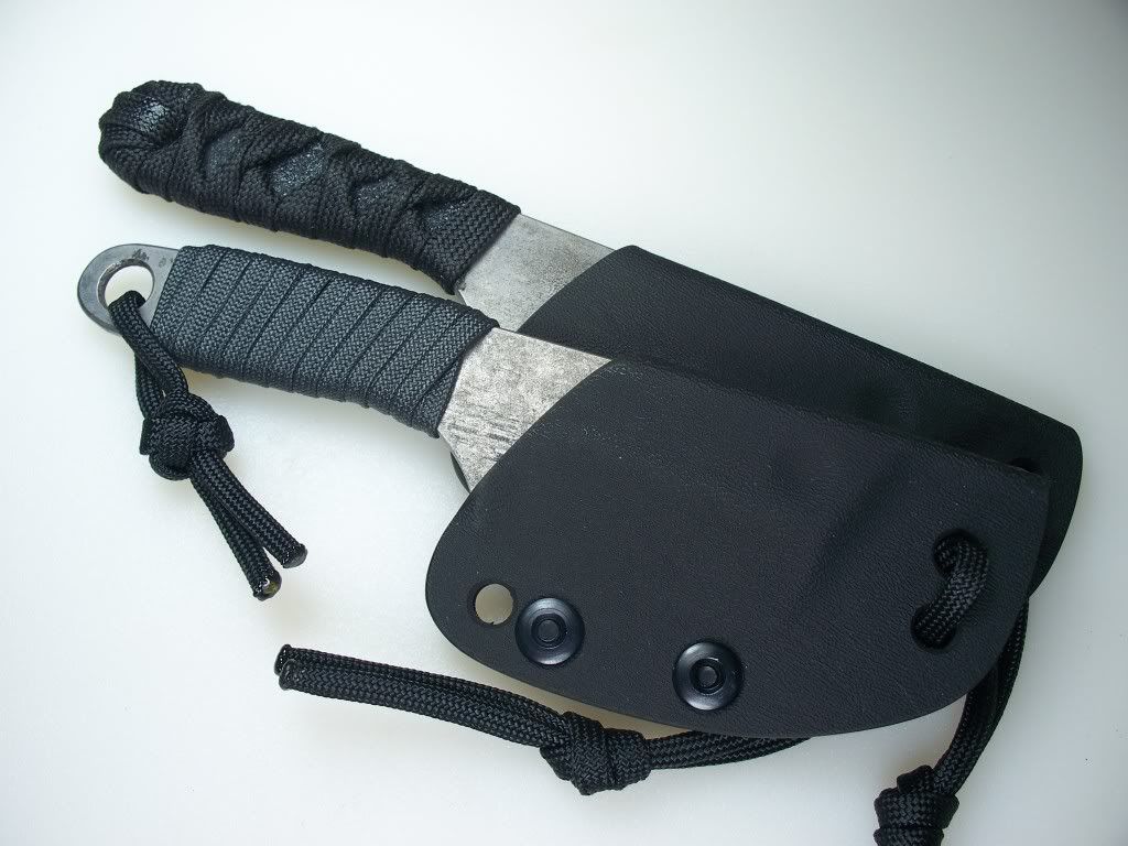

These need to be West System epoxy soaked, after that it is time for sheaths and a final stropping.
