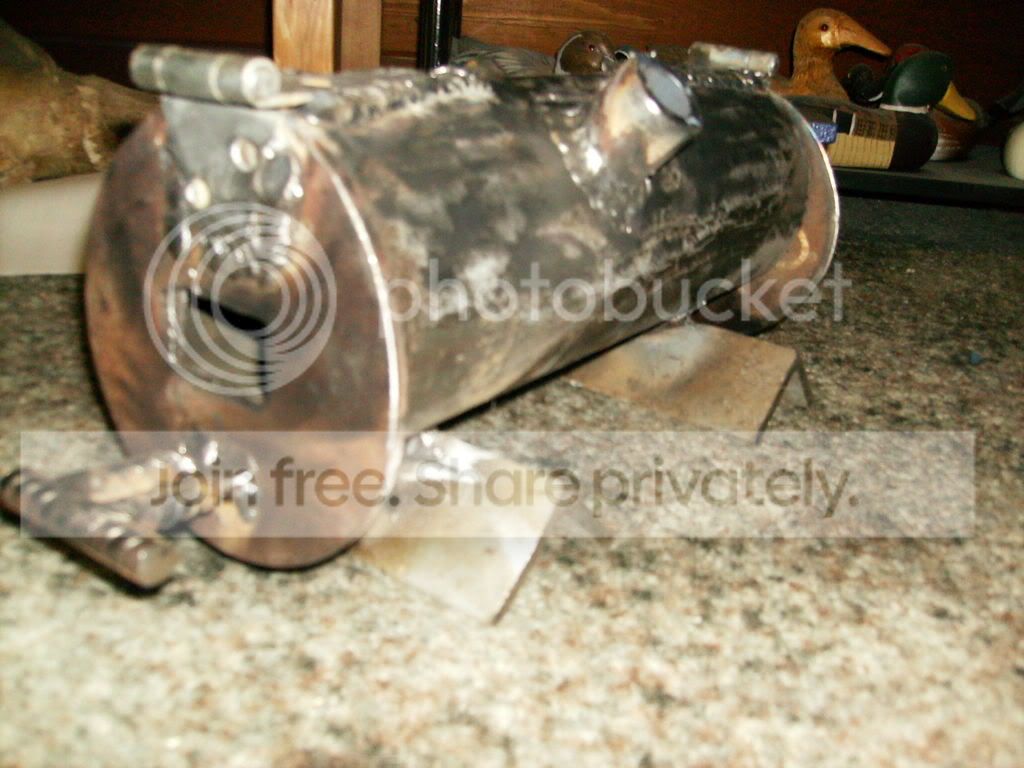

I am building a mini forge . Its inside the house hopefully its ok .I just started on it today my friend had some thick wall pipe its 1/2 inch thick and inside has a 4 inch opening. I welded some 2x2 angle on for legs at either end and made 2 round doors that will be welded to a hinge to open . The 2 holes will be cut in the pipe and then 2 small 1 1/4 inch pipe welded to that handles of rebar for the doors and a 1 1/2 inch rectangular viewing window. I will use 2 propane soldering torches for my heat source. I will make a better one in a few months it takes time to get all the stuff soft furnace bricks are hard to come by.the holes for the torches will be on opposite sides of the pipe and 3 inches apart in the center area of the forge. Any sugestions to make it better. I have no refratory brick or cement yet and where can i find insa wool . ALL SUGGESTIONS WELCOME THANKS KELLYW

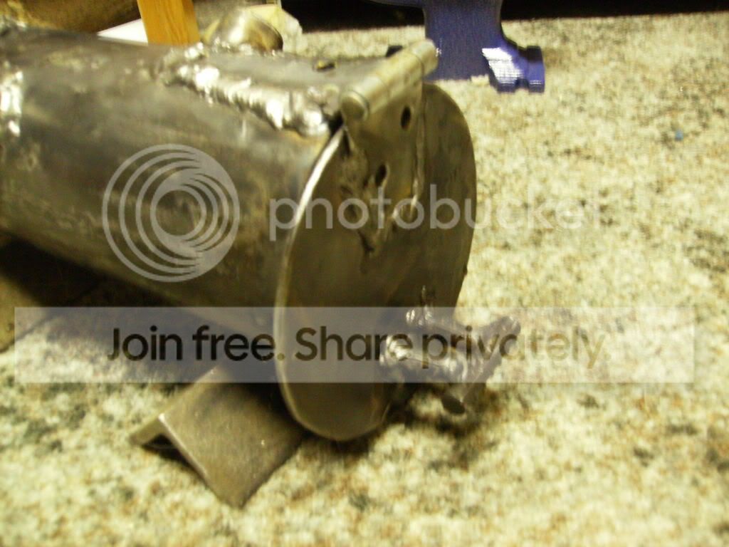

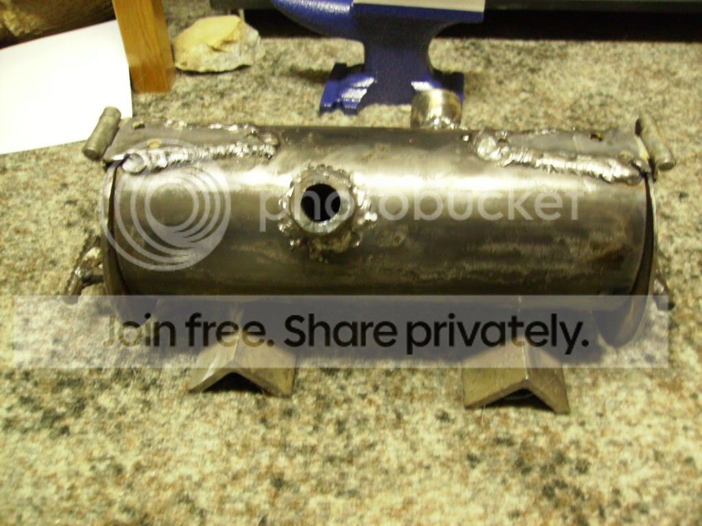

patrick and blalongi thanks for the help and advice will i need 2 torches and this pipe is 4inch diameter so if i use 1 inch fire matt that will still work fine here is my forge i finished it today.
Kelly, you're right, you DO weld ugly :p
Looks like a nice forge, I'm not sure about the 2 torches in the middle like that but I've never run a small forge like that.
You will probably need two torches, I'm assuming JTH-7s, because a 4" pipe won't leave you much room for a chamber after you install the kaowool and coat it with satanite or watered down furnace cement. The walls of the forge will have to be very thin in order to make it usable, which means it won't be very efficient and retain heat.
Oh, and I run a single JTH 7 in a double coffee can forge and am able to do most anything short of forge welding.
They are only $29.99 at Lowes.

Hellgap, you will need to get some ITC-100 to seal the kaowool. You can get it all from Ellis Custom Knife Works.
Good design. I would have made the burners come in on the same side so they won't be fighting each other for swirl. You may have a cold spot in the middle.
I second the JTH-7s. That thing is less like a propane torch and more like a small jet engine. It packs a lot of power for such a small size. Get a propane tree and hoses and run it off of a 20lb tank. Anything less you will be dissapointed with.
I run a single JTH-7 in a stacked brick forge and I can easily forge weld with it, but it has a pretty small chamber.
thanks ya all thats what im going to get i dont think ill need 2 torches my inside area will be like 2 inches x 12 once i put the wool in my inside diameter is only 4 inches a little to small i didnt know that the wool was that good that i didnt need to have thick walls or i woulda built a bigger one. Also my friend has all kinds of big stainless pipe he said i could have a 18 or 24 inch diameter piece but i think thats a little to much and its to hard to weld for me.Oh ya the JTH7 was what im looking for for a torch where do i get an adaptor for a 20 pound tank . thanks kellyw

With a chamber that long, one torch burner will not get the forge evenly heated, in my opinion. I think you should go with two or look into a forced air solution. As far as the walls, they really just hold things together, I built a forge with just the ceramic blanket and satanite once, I simply smeared satanite evenly across an entire bit of blanket and then rolled it up.
I don't know about forced air in a forge this small. I would worry about having a really hot spot where the flame enters. You'd probably have serious scaling issues in the center of a very small chamber with a forced air burner.
