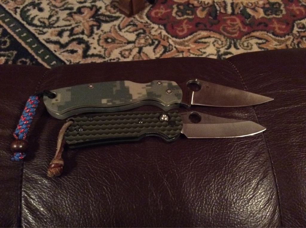

Which is better? And is there a very noticeable difference. I have a pm2 in s30v I carry with my mini grip in 154 And the edge holding on both is really equal almost my pm2 holds an edge slightly longer I guess.

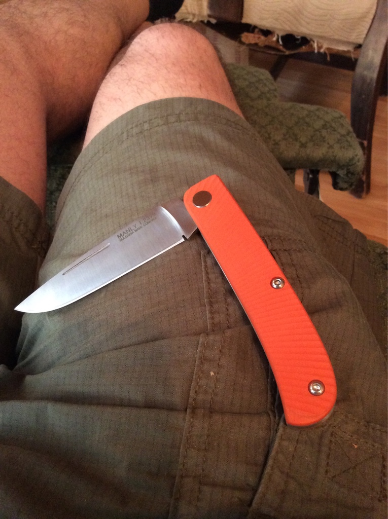

I also saw you could get the blade in D2 as well I have a manly folder in d2 it seems like good steel as well. So which steel is benchmade best with?

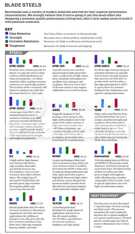

The choices are 154cm, d2, n680, s30v, m4, 20cv.
20cv and n680 are tied as least tough of all the choices.
M4 is the toughest and probably strongest. It and 20cv have the best edge retention of all choices.
M4 will have the best edge stability by far.

20CV and M390 are almost identical in terms of element composition (and CTS-204P is the same as them too).
Benchmade has said on their forums that they do heat treat them slightly differently, and get a little more toughness out of M390 and a little more edge retention out of 20CV. (look at post #3)
