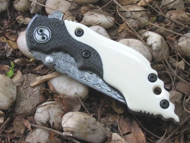

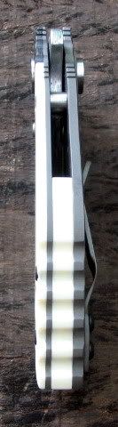

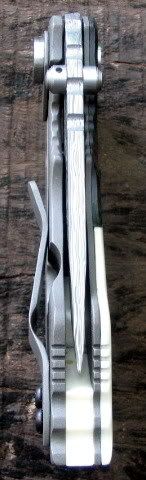

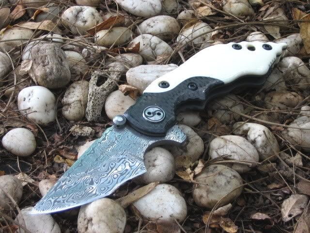

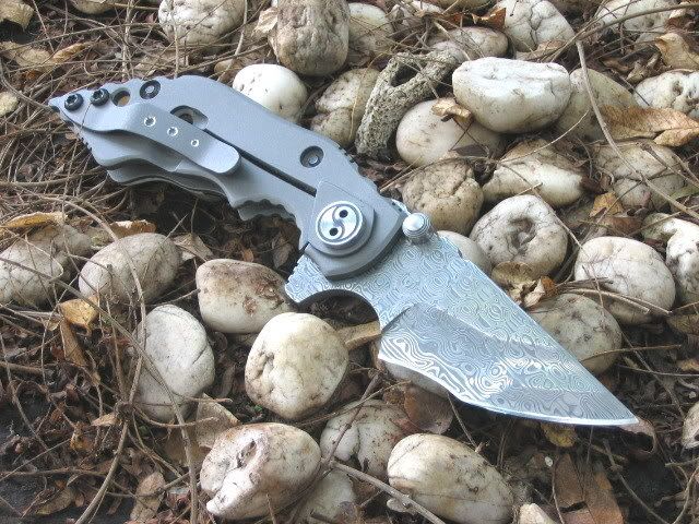

Hi all,
Finished and sent it to LA. This is not ordinary model.
The grinding is complex grind, hollow grind on edge and flat on tip. Spec is :
Blade steel : Damasteel, RWL-34 damascus
Thickness : 4mm.
Blade length : 3 "
Closed length : 4 1/2"
Opened length : 8 3/4"
Width : 1 1/2"
Bolster : Carbon fiber
Handle, Black spacer : Old elephant ivory.
Frame : 6AL 4V titanium 1/8" thickness.
Frame stop : 6AL 4V titanium
Spacer/ Clip : 6AL 4V titanium
Pivot : Hardened 440C in Yin-Yang style.
Thanks for looking and comments.
